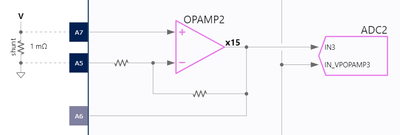

I want to use MCU pin A6 for something else and OPAMP2 to ADC2-IN3 shall be internally connected only.
G4 Reference manual page 779 figure 171 says:
  1. opamp_out can be redirected internally to an ADC channel by setting OPAINTOEN bit.
In this case, the I/O on which is mapped the OPAMPx_VOUT is free and can be used for another purpose. In standalone mode, VOUT pin is disconnected from the OPAMP output and the gain cannot be set by an external resistors (in this case OPAMP can be used only as comparator).
When I look at MCSDK generated code I see, that OPAINTOEN is disabled. According to docu above this means, OPAMP out is not connected to ADC ???

And when I change the line to LL_OPAMP_INTERNAL_OUPUT_ENABLED, code is not working anymore.
Questions:
  • is the documentation in the reference manual wrong?
  • is it not possible to use the pin A6 for another purpose?
    • if it is possible, how?
Thanks,

Assuming that is a STM32G4, the case presented in the figure, OPAMP2 output is connected to PA6 and ADC2_IN3 input is connected to PA6.
Still on STM32G4, refer to "Table 204. Operational amplifier possible connection" on STM32G4 series reference manual, ADC2_IN3 is not accessible via an OpAmp direct connection. It is the case with ADC_IN16 input.

I replaced the following 2 lines in code, generated by MCSDK 6.4.0:
// LL_ADC_INJ_SetSequencerRanks(ADC2, LL_ADC_INJ_RANK_2, LL_ADC_CHANNEL_3);
LL_ADC_INJ_SetSequencerRanks(ADC2, LL_ADC_INJ_RANK_2, LL_ADC_CHANNEL_16);
// LL_OPAMP_SetInternalOutput(OPAMP2, LL_OPAMP_INTERNAL_OUPUT_DISABLED);
LL_OPAMP_SetInternalOutput(OPAMP2, LL_OPAMP_INTERNAL_OUPUT_ENABLED);
 But then motor is not spinning anymore.
What am I missing?
