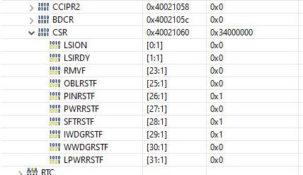

     Our controller was running fairly well but on occasion we were seeing the windowed watchdog trip(The IWDDGRSTF flag set on reboot.) We were not sure whether this was a too short or too long trip so decided to extend the window wider(set the Reload counter from 1800 to 2500.) The kick logic runs from the system clock and is set to reload the every 1.0 second or greater.
     The original window should be running between ~781msec and 1.77 sec +/- the 32kHz clock inaccuracy. What is odd is that this work very well but on occasion would trip. But simply expanding the end of the window to 2.44 sec (~781msec to 2.44 sec) the watchdog trips frequently.

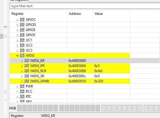

If the reload operation is performed while the counter is greater than the value stored in the IWDG window register (IWDG_WINR), then a reset is provided.
     We needed to use a higher number for the Window value as if you want to kick the window watchdog every second, the window value needs to be one second below the timeout value.

	// Set the IWDG window value to 3000.
	// (0.9765msec * 3000) = 2.9295 sec.
	LL_IWDG_SetWindow(IWDG, 3000);
