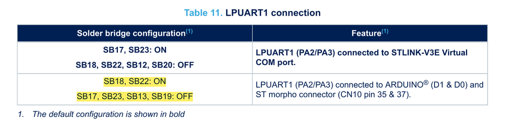

I am using Nucleo-G491RE. I am debugging through the built-in ST-Link using STM32CubeIDE 1.18.1. My design uses opamp1 in standalone mode, which assigns OPAMP1_VOUT to PA2 and OPAMP1_VINM to PA3. What configuration of solder bridges will bring these opamp signals to the Arduino or Morpho connectors?  I have studied the user manual (MB1367) section 6.7, but it is not clear to me.
SB18/SB22 on
SB13/SB17/SB19/SB23 off
PA2/PA3 are then brought to the headers instead of the default PC4/PC5.

Andrew Neil
It might be clearer to look at the schematics?
Thank you. Where can I find the schematics? I have looked.
On the product page under CAD Resources.
https://www.st.com/en/evaluation-tools/nucleo-g491re.html#cad-resources
https://www.st.com/resource/en/schematic_pack/mb1367-g491re-c05_schematic.pdf
