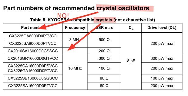

AN2867: Guidelines for oscillator design on STM8AF/AL/S and STM32 MCUs/MPUs
mixes and shifts between related terms multiple times in its 59 pages. The resulting confusion is enormous. Instead of working to remove confusion, ST's documentation contributes to it:
which is followed immediately by
Dear ST,  please flag this AN for review and urge the documentation team to be absolute tyrants about correct usage.

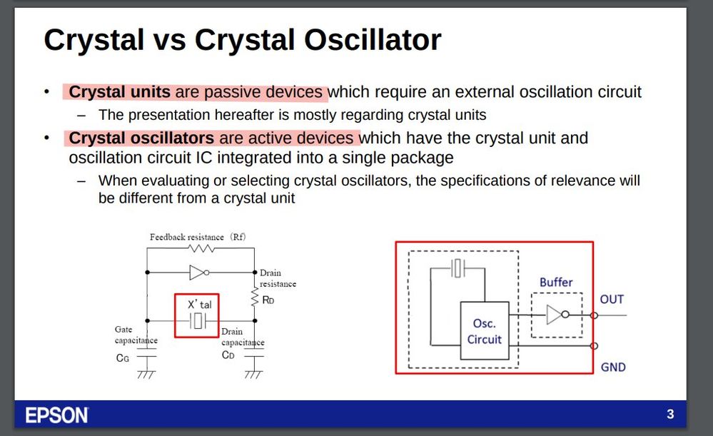

From [EPSON] Crystal Fundamentals & State of the Industry :
If ST writers lack a catch-all term, perhaps "Frequency Source" would do, instead of randomly selecting one of the three (crystal, oscillator, resonator) on each occasion. Including a glossary placed at the start of the appnote would enhance clarity as well.

Dear @BarryWhit @Andrew Neil ,
Thank you for the feedback. I concur your message and Will be taken into account in our next Release . Indeed nowadays “resonators” are rarely used IMHO as most of modern MCUs have very nice RC / HSI / MSI precision low cost internal oscillators , this was not the case 20 years ago where they are very famous and especially from Murata. As we work with many crystal partners we have close contact with all of them and major breakthrough the last decade was : Ultra low power and very small PCB footprint to reach 1016 and even lower size while keeping very high precision including Wireless communications and asynchronous clocking : Ethernet, USB etc.
well received for the AN2867 !

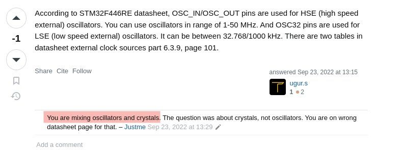

So... no internal ticket for this?
This term confusion is an engineering epidemic. ST should make an effort to stop this confusion by explicitly calling this common error out in documentation, and should also avoid making it themselves in their literature.
From SE:
I'd say that "resonator" is a generic term which includes both crystal resonators and ceramic resonators - maybe even RC and LC ...
But, whatever, the document should give a clear definition of the terms it's going to use, and then stick consistently to those terms as defined.
