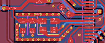

How is the oscillator connected, exactly?
‎2025-05-29 1:16 AM - edited ‎2025-05-29 1:17 AM
2 capacitors there are 100nF and 1nF respectively.
I already tried cutting enable trace (floating enable = working oscillator) or using an external waveform generator. All approaches yield identical results.
