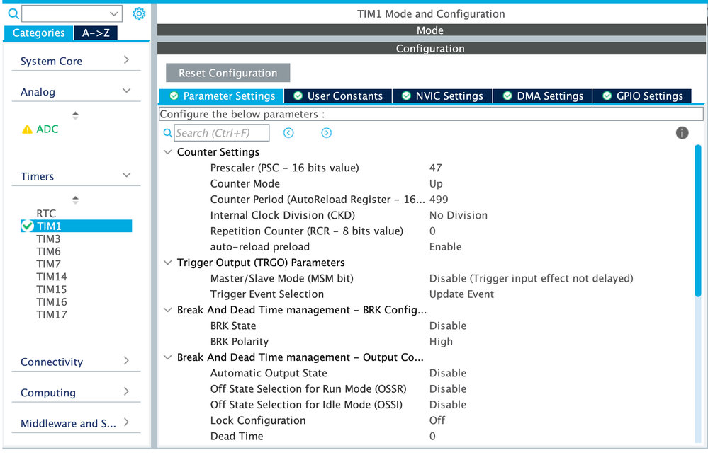

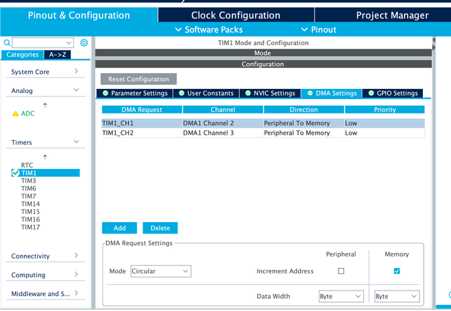

Hello ,
I want to make 4 channel PWM signal using TIM1 (with complimentory also)  .While the TIM1 is used to triger the ADC to get sample .
I am getting the pwm wave , But  ADC is not triggering or not working . What configuration i require
Please see more details below

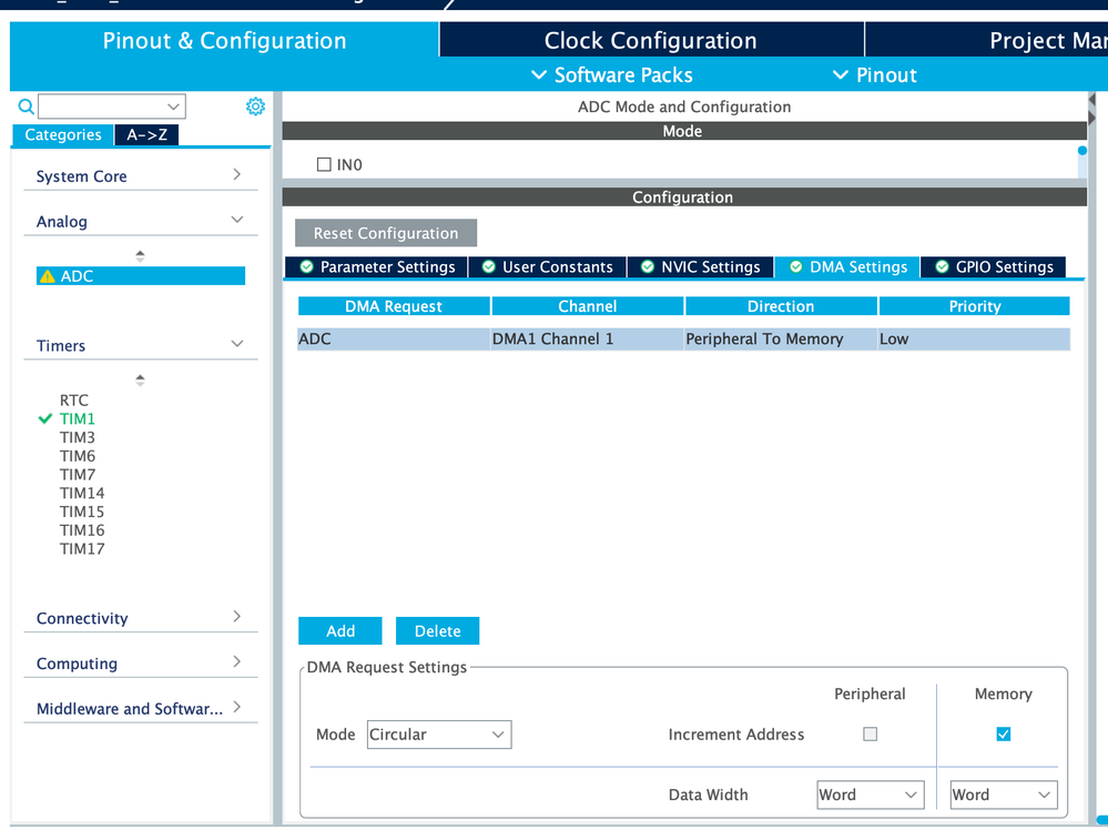

I am Trying to generate 2 Channel PWM Genertaion [ CH1 CHN and  PWD Generation CH2CH2N ] from  DMA  Buffer .
   HAL_TIM_PWM_Start_DMA(&htim1, TIM_CHANNEL_1, (uint32_t *)sin_table, 160);
    HAL_TIMEx_PWMN_Start_IT(&htim1, TIM_CHANNEL_1);
    HAL_TIM_PWM_Start_DMA(&htim1, TIM_CHANNEL_2, (uint32_t *)sin_table, 160);
    HAL_TIMEx_PWMN_Start_IT(&htim1, TIM_CHANNEL_2);
Configuration as follows

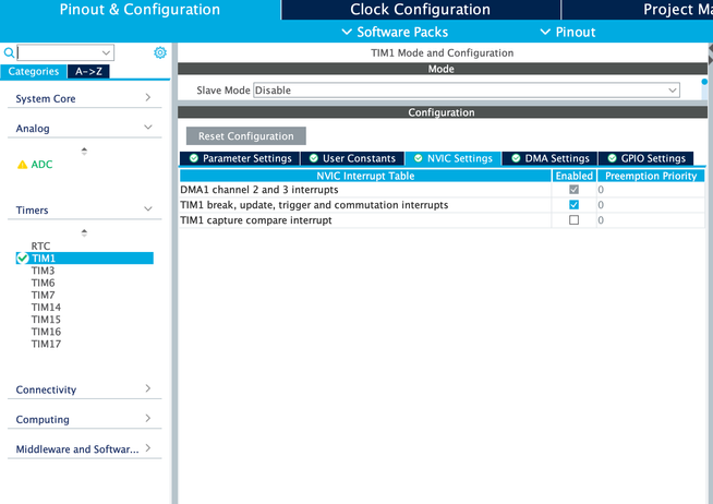

Screenshot 2024-04-26 at 2.44.46 PM.pngScreenshot 2024-04-26 at 2.45.24 PM.png
While PWM generation am trying to  TIM1 is  to triger the  ADC

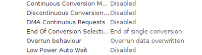

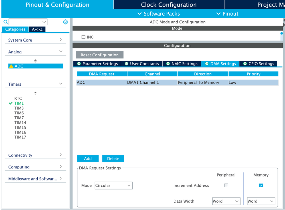

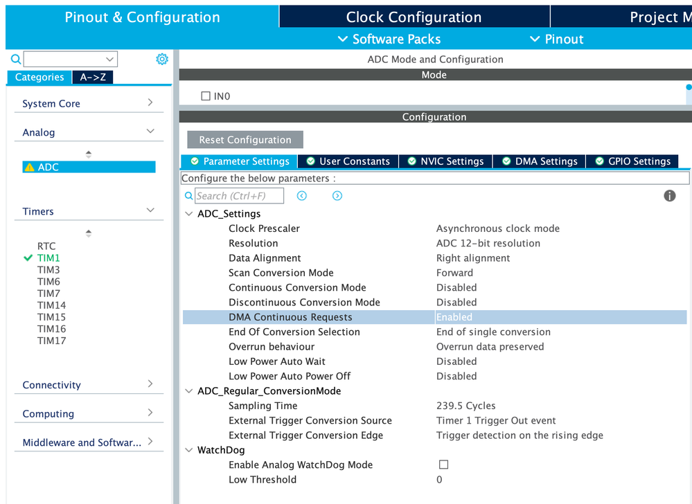

The ADC configured as follows
HAL_ADCEx_Calibration_Start(&hadc);
HAL_ADC_Start_DMA(&hadc, (uint32_t *)ADC_RES, 200);
Am here attached the main.c file

just what i see now : not enable continuous..
adc...dma:
see my use case : tim8 -> trigger -> adc (with dma )
tim8:
adc:
start in main.c : (but i use not circular dma here, doing just one 512 sample-shot.)
retval = HAL_ADC_Start_DMA(&hadc1, (uint32_t *) &sampels[nu][0], 512);
while(HAL_DMA_GetState(&hdma_adc1) > HAL_DMA_STATE_READY) {};	// wait for ready
thannara123
Senior
I tried DMA continuous. request turned off ?
If circular mode turn off is it restart from zero after 512 ?
Other configuration is correct in my case ?
In the below code i didnt get the trigger in GPIOC Pin4  what is the wrong with me ?
void HAL_TIM_PeriodElapsedCallback(TIM_HandleTypeDef *htim)
{      if (htim->Instance == TIM1)
            { t occurs HAL_GPIO_TogglePin(GPIOC, GPIO_PIN_4);
Just try it.
Yes, without circular mode : just filling the array one time. (Same as "one shot" on a DSO .)
Next dma start...same again.
Hmmm...try. If you want continuous operation, then circular mode is correct; you have to use/copy data then in half/full callbacks - or just let it run. Only one dma-start needed here, it will loop always/endless and fill the array.
