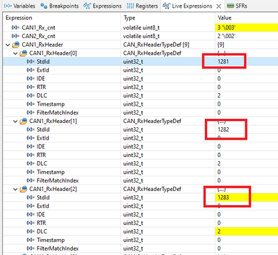

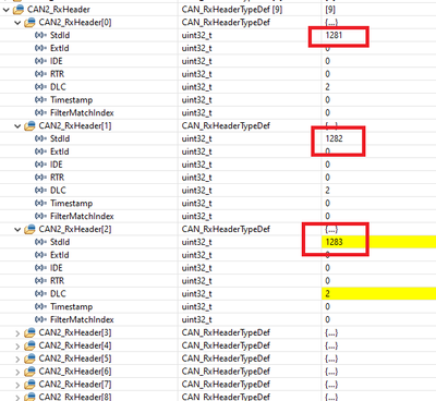

I've created a simple project where CAN1 and CAN2 are in loopback mode using STM32F407 Discovery board and I'm receiving well all the sent IDs: 0x502 (1281), 0x502 (1282), 0x503 (1283) on both sides CAN1 and CAN2:
CAN1 Rx:
CAN2 Rx:
I've attached the project.
I've also used that configuration and worked fine:
  sFilterConfig.FilterBank = 0;
  sFilterConfig.FilterMode = CAN_FILTERMODE_IDMASK;
  sFilterConfig.FilterScale = CAN_FILTERSCALE_32BIT;
  sFilterConfig.FilterIdHigh = (0x501 << 5);
  sFilterConfig.FilterIdLow = 0x0000;
  sFilterConfig.FilterMaskIdHigh = (0xFFC << 5);
  sFilterConfig.FilterMaskIdLow = 0x0000;
  sFilterConfig.FilterFIFOAssignment = CAN_RX_FIFO0;
  sFilterConfig.FilterActivation = ENABLE;
  sFilterConfig.SlaveStartFilterBank = 1;
  if(HAL_CAN_ConfigFilter(&hcan1, &sFilterConfig) != HAL_OK)
    /* Filter configuration Error */
    Error_Handler();
  sFilterConfig.FilterBank = 1;
  if(HAL_CAN_ConfigFilter(&hcan2, &sFilterConfig) != HAL_OK)
    Error_Handler();
So I suspect something wrong in your specific implementation, either in your Can_IPW_Can_ConfigFilter() or with the handler hcan that was not set correctly in your software.
