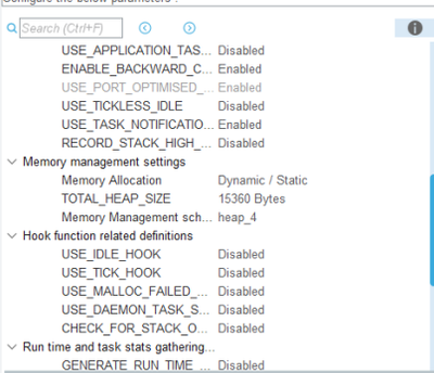

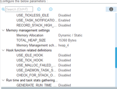

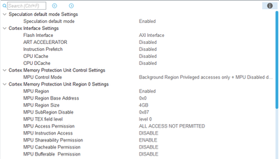

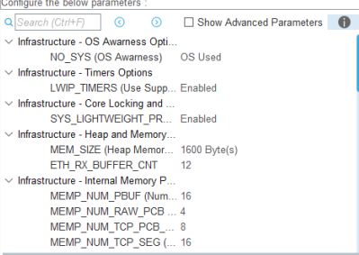

I tried flashing this exact same code onto a STM32F746G-DISCO, and it works perfectly, regardless of the string contained in echo_msg. The MPU configuration is the same for both:

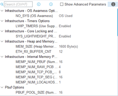

All the settings for freeRTOS and LwIP are set to default, except for the defaultTask stack size, which I set to 512 words.

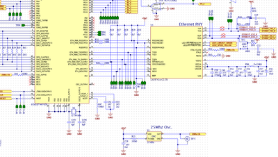

Here is the partial board schematic:

Hello STea,
Took us some time to solve the issue, but it turned out that our VCAP1 and VCAP2 capacitors for the regulator stabilization were installed incorrectly at a value of 2.2 nF. When we replaced the capacitors with the proper value of 2.2 uF, all our issues were resolved.

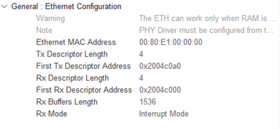

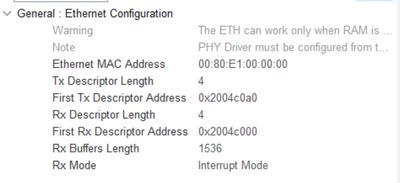

also, could you check the placement of the ethernet descriptors and Lwip heap and the way you are allocating stack for your FreeRtos tasks?

Hello STea,
Thank you for your response. Yes, when I flash the same code onto the STM32F746G-DISCO board, I don't get any hard faults. I have checked the placement of the ethernet descriptors, the LwIP heap, and the freeRTOS task stacks. They are all the exact same for both boards. I've attached the associated configurations below.

if the Firmware is working on the Disco board and not on your custom board clearly this is a Hardware issue. here are some things to look for
make sure you have the same part number for your board.
make sure also that the .ld file places the descriptors in the same region as the Discovery board and that the memory region definitions are the same.
you said that it worked with small amount of Data so misconfiguration or soldering issue with the PHY is out of the table
I hope you find a solution to this soon and don't hesitate to update us on this issue as this is very unorthodox to see.
