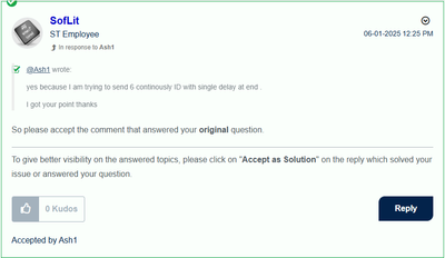

@Ash1 wrote:
yes because I am trying to send 6 continously ID with single delay at end .
I got your point thanks
So please accept the comment that answered your original question.
PS:
1 - This is NOT an online support (https://ols.st.com) but a collaborative space.
2 - Please be polite in your reply. Otherwise, it will be reported as inappropriate and you will be permanently blacklisted from my help.
SofLit
You accepted the wrong comment:
I will mark the nearest comment that answered your question as "Accepted as Solution".
