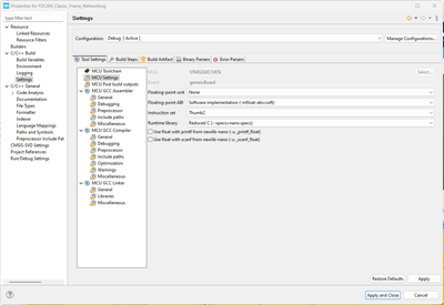

Please tell me what are the exact steps to porting the FDCAN_Classic_Frame_Networking example from the STM32G0C1VETX CPU you reference above to my STM32H735IGK6 CPU on my STM32H735G-DK board. I have tried importing the project and importing the example, creating a new project with the h735 and importing source from the G0C1, but CubeIDE still references the old  STM32G0C1VETX builds files and fails.
I forgot to mention this..... The project properties to change the MCU type is not available.

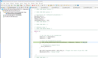

I initialize hfdcan1 to the following:
hfdcan1.Instance = FDCAN1;
//hfdcan1.Init.ClockDivider = FDCAN_CLOCK_DIV1;
hfdcan1.Init.FrameFormat = FDCAN_FRAME_FD_BRS;
hfdcan1.Init.Mode = FDCAN_MODE_NORMAL;
hfdcan1.Init.AutoRetransmission = ENABLE;
hfdcan1.Init.TransmitPause = ENABLE;
hfdcan1.Init.ProtocolException = DISABLE;
hfdcan1.Init.NominalPrescaler = 1;
hfdcan1.Init.NominalSyncJumpWidth = 16;
hfdcan1.Init.NominalTimeSeg1 = 63;
hfdcan1.Init.NominalTimeSeg2 = 16;
hfdcan1.Init.DataPrescaler = 1;
hfdcan1.Init.DataSyncJumpWidth = 4;
hfdcan1.Init.DataTimeSeg1 = 5;
hfdcan1.Init.DataTimeSeg2 = 4;
hfdcan1.Init.StdFiltersNbr = 1;
hfdcan1.Init.ExtFiltersNbr = 0;
and set my TxHeader as:
/* Prepare Tx Header */
TxHeader.Identifier = 0x321;
TxHeader.IdType = FDCAN_STANDARD_ID;
TxHeader.TxFrameType = FDCAN_DATA_FRAME;
TxHeader.DataLength = FDCAN_DLC_BYTES_2;
TxHeader.ErrorStateIndicator = FDCAN_ESI_ACTIVE;
TxHeader.BitRateSwitch = FDCAN_BRS_OFF;
TxHeader.FDFormat = FDCAN_CLASSIC_CAN;
TxHeader.TxEventFifoControl = FDCAN_NO_TX_EVENTS;
TxHeader.MessageMarker = 0;

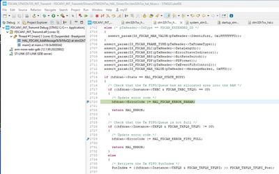

I Debug Trace all HAL functions prior to HAL_FDCAN_AddMessageToTxFifoQ, they are all HAL_OK, but
Once I enter the HAL_FDCAN_AddMessageToTxBuffer function, HAL reports a parameter  incorrect error:
Hello @tmlee_mts ,
Refer to Projects\STM32H743I-EVAL\Examples\FDCAN\FDCAN_Classic_Frame_Networking (from STM32CubeH7) instead of STM32G0C1 (not the same family). But you have to check the clocks where you have some differences.
