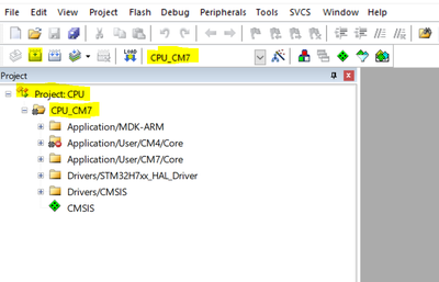

I am using STM32H747i-DISCO board to create multicore MDK-ARM project using STM32cubemx and Cubemx will create the project with both cores under same project file, but when i build that project it will show multiple main file error. How to create a project for individual core separately under same project name as in the STM32cubeIDE.

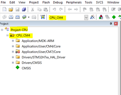

For multicore MDK-ARM project and after generation project using STM32CubeMX, you can built individual core separately (M7 and M4) as shown in the below figure
I hope this answer your request.
