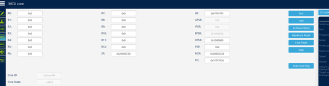

Then I made sure I'm in the bootloader from STM32 Programmer. That the PC (Program counter) in the Bootloader range (at 0x1FFF0000)
PC
And I followed the flow chart in AN2606, and AN3154(CAN protocol used in the stm32 bootloader).
But it not responding, I'm able to send and receive can messages between my STM32L433 Neucluo Board and Beagle Bone AI (using python in BB AI) before STM32 enter Bootloader mode, but AFTER the stm32 enter the bootloader mode it will not response to any message.

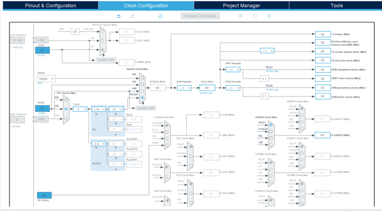

Hi Imen,
I’m working with the Nucleo STM32L433 and don’t have an external clock available. Do I need to solder on an external clock, or can I use the internal HSI? I’ve configured the HSI to run at 60 MHz and set the CAN baud rate to 125 Kbps.
