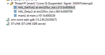

I am trying to toggle one of the LED lights of STM32 NUCLEO-L552ZE-Q board. I am working with the latest version of STM32CubeIDE 1.16.1. The steps I followed are given in the picture. However, I find this error when I debugg:
set *(int *)0xE000EDFC=*(int *)0xE000EDFC|0xFF0
Program received signal SIGINT, Interrupt.
0x080006bc in HAL_IncTick () at ../Drivers/STM32L5xx_HAL_Driver/Src/stm32l5xx_hal.c:303
303 }
Also, the pics show more. I tried many things to fix this issue but couldn't.
Has someone face the same issue and how did you solve it? Any help is highly appreciated.

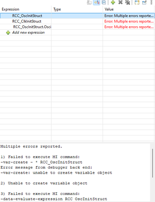

The images of the errors:
Am I doing something wrong in the configuration or ???

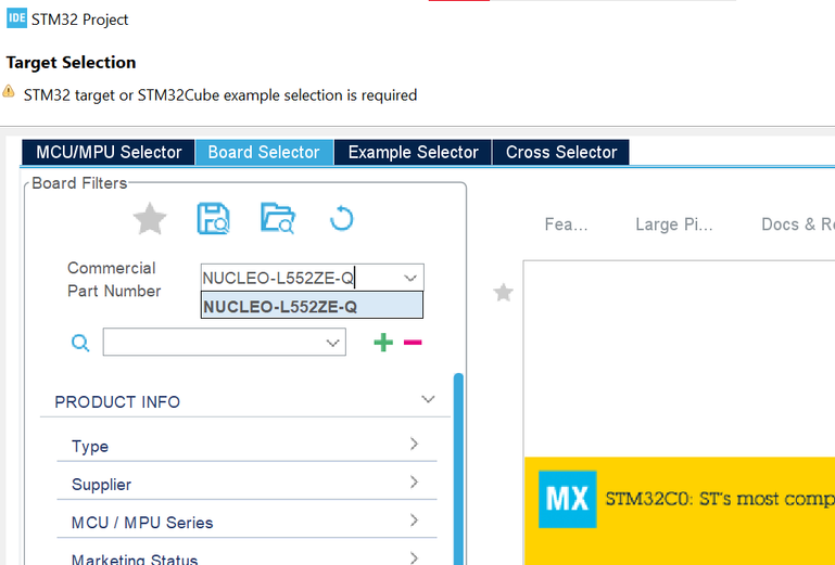

Why is your clock at 4MHz? Anyways, why don't you use the Board Selector which will make sure everything is optimally setup including the clock.

It didn't work unfortunately :(
It didn't work. This was the result.

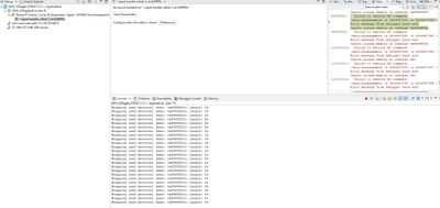

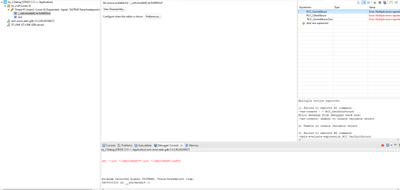

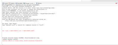

So I created a new workspace, with all the default settings. The I went to file -> Import -> Existing projects into workspace-
Then next. Then I built the code, I tried to debug it and I get this:
