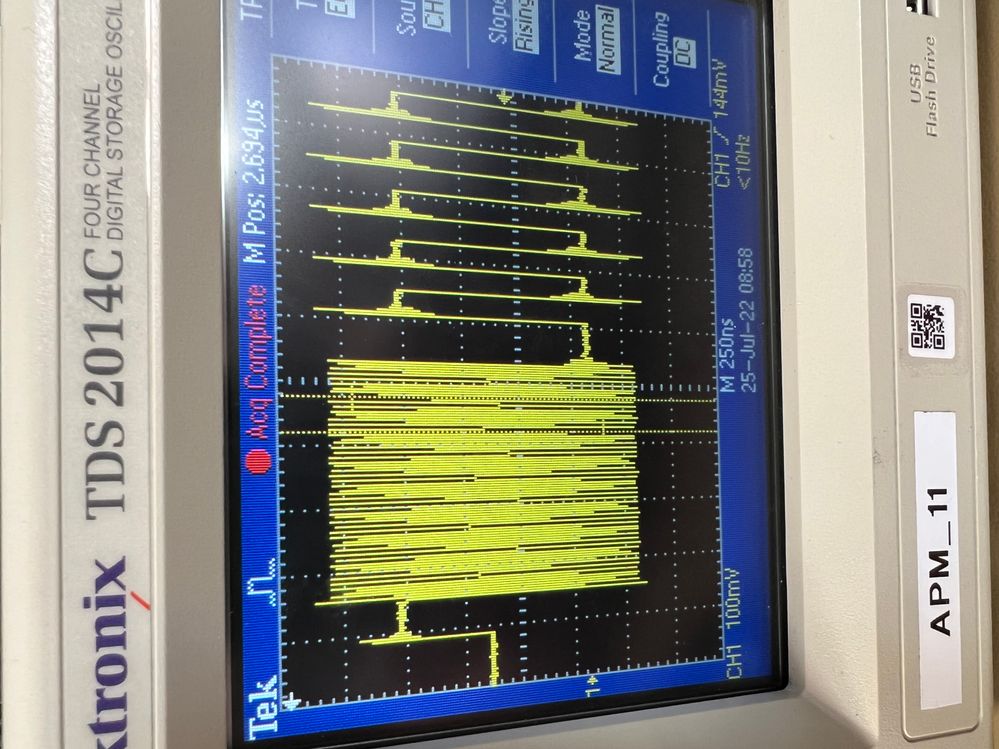

Hi I'm trying to generate a signal with 100 ns time on and 100 ns time off thanks to DMA transfer. My problem is that I have a peak of tension before and I don't know what is it (F446RE)
0693W00000QM2iNQAT.jpgHere is my code:

I found the problem -> set pin to no pull up no pull down and -> Enable alternate fucntion of pin and timers at the end of all initialisations

Debug your code step by step with the scope connected and find which statement causes what behaviour.
Btw, I don't see a reason for using DMA for such a regular waveform, but you might have your reasons.
 TIM2->CR1 |=CR1_CEN;
 DMA1_Stream1->CR|= (1<<0);
 GPIOA->AFR[0] |=AFR5_TIM;
