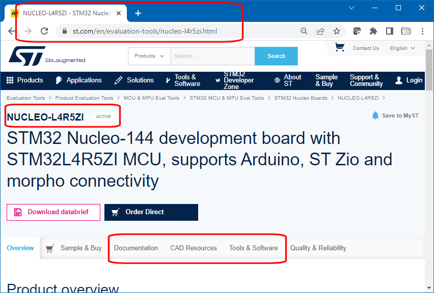

I bought Nucleo-L4R5ZI.
I can't find any document with HW information such as memory map, registers, etc. for Nucleo-L4R5ZI.
I could find a document with HW layout and other information.
Where can I find a document that contains HW information such as memory maps, registers, etc. for Nucleo-L4R5ZI?

The schematic is under the "CAD Resources" tab of the NUCLEO-L4R5ZI page

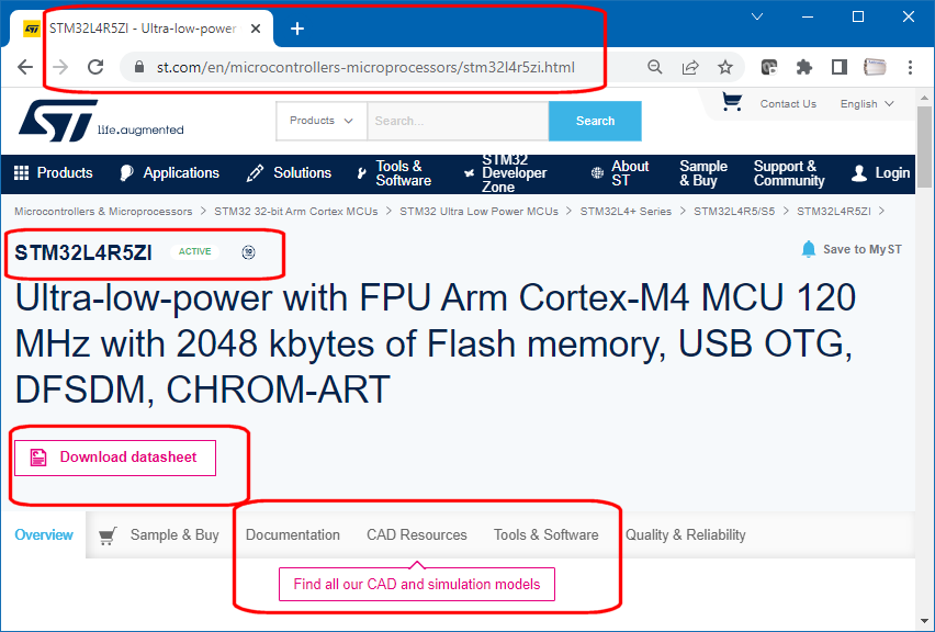

Documentation for the STM32L4R5ZI is under that products page, pining in Data Sheet, registers in Reference Manual under "Documentation" tab

@Myasu.1​ "I can't find any document with HW information such as memory map, registers, etc. for Nucleo-L4R5ZI"
Those things are defined by the microcontroller chip - not by the board it's on.
Therefore, as @Community member​ said, you need to be looking in the chip datasheet for that info.
"Where can I find a document"
The place to start for all documentation is always the Product Page - there is one for the board:
And one for the chip:
You can easily find the Product Page for a product by just putting its part number - here, eg, "STM32L4R5ZI" and "Nucleo-L4R5ZI" - into google.
