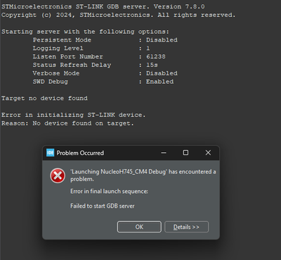

M7 gets debugged and runs. Once I start with M4 I get error messages and it bricks the controller.
I have been pulling up the BOOT0 pin and performing mass erase and trying things again, still it gets bricked when I try to debug CM4.

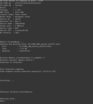

Without debugger CM7 gets compiled and download completes.
When I try to run CM4 then the error pops up. But it doesn't brick the controller this time.

When I click on run for CM7, This is what happens on console.

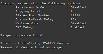

Similarly, When I run CM4, This is what I get on console,
Hope you understood the issue. Please let me know, If you require further information.

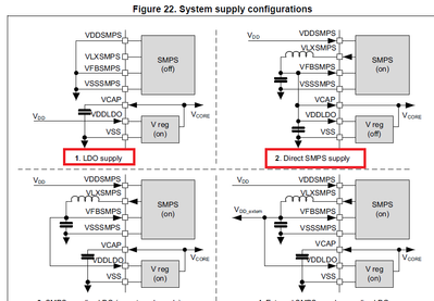

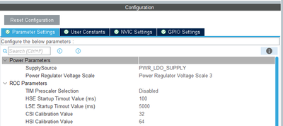

We are using a custom STM32H745ZIT6 board with LDO Supply config.
And are you sure your board is configured in LDO by HW and the RCC power config in your software follows?

Yes, It is.

Also you said: "The board is designed with Nucleo-H745ZI-Q schematics"
Nucleo-H745ZI-Q board is using SMPS and not LDO configuration. Could you confirm you are not using SMPS in the HW?
If you used SMPS, that's normal and you've broken the board. In that case you need to recover it. Read this article.
