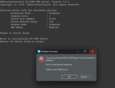

M7 gets debugged and runs. Once I start with M4 I get error messages and it bricks the controller.
I have been pulling up the BOOT0 pin and performing mass erase and trying things again, still it gets bricked when I try to debug CM4.

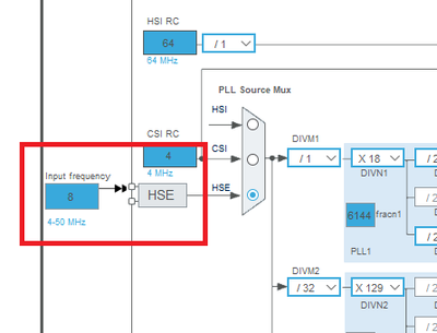

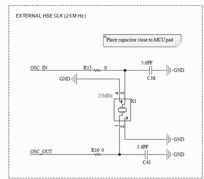

There is a mismatch between your RCC config i.e. you set an external 8MHz source in Bypass mode:
While in your schematics you have an external clock with 25Mhz / Crystal/Resonator mode:

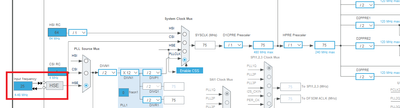

You need to align the RCC config to fit your HW:
Attached the updated ioc file.
2024-11-28 04:17 AM
Hello SofLit,
Thank you, CM7 boots up and blink sketch works on the board.
But CM4 remains the same. It doesn't get detected at all. Any idea why?
2024-11-28 05:02 AM - edited 2024-11-28 05:06 AM
Please comment these two lines in the main of CM4:
HAL_PWREx_ClearPendingEvent();
HAL_PWREx_EnterSTOPMode(PWR_MAINREGULATOR_ON, PWR_STOPENTRY_WFE, PWR_D2_DOMAIN);
These lines make the CM4 to enter in low power mode while debugging.
For debug, I suggest you to comment these lines but you can keep them while in standalone.
