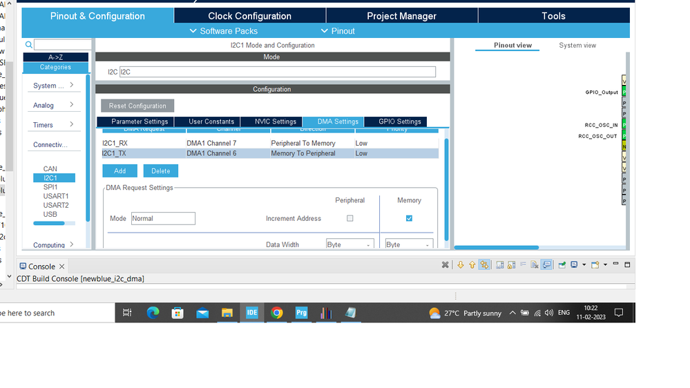

bh1750 sensor i2c poll method working fine but i2c DMA method not working with attached code . will DMA only transfer the value to global variable ?

i am able to getting result with i2c DMA with following .
if(HAL_I2C_Mem_Read_DMA(bh1750_i2c, BH1750_ADDRESS, BH1750_ADDRESS, 1, tmp, 2)!=HAL_OK
instead of
if(HAL_I2C_Master_Receive_DMA(bh1750_i2c, BH1750_ADDRESS, tmp, 2)!=HAL_OK)
i am did know why Master_Receive_DMA is not working and Mem_Read_DMA is working .
Bh1750 sensor having single register Master_Receive_DMA is passing only one time read address with read bit but Mem_Read_DMA sending one time read address with read bit and additionally sending same read address without read bit but it's working .may be some one explain
KnarfB
HAL_I2C_Master_Receive_DMA will immediately return, before the buffer is filled. So it makes no sense providing a stack local variable.
The clines afterward must belong to a completion handler, which is called after DMA was completed.
If you put them directly under HAL_I2C_Master_Receive_DMA, it may or may not work depending on timing, but this is principially wrong.
hth
