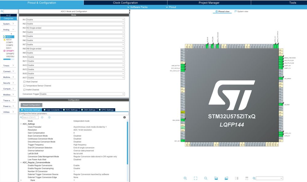

Hi I created a very simple ADC polling project using Nucleo-U575ZI-Q board. The settings of CubeMX is attached below. The code is very simple, just start the ADC1 and wait for polling then read the result from ADC1_IN8. The ADC polling code in my own project is not working. But when putting the same code in the ST ADC example project, it can work. I assume some settings must be missed but I checked all the settings and functions used and they are the same for my project and example project. Can anyone figure out which key steps are missed? Thanks.

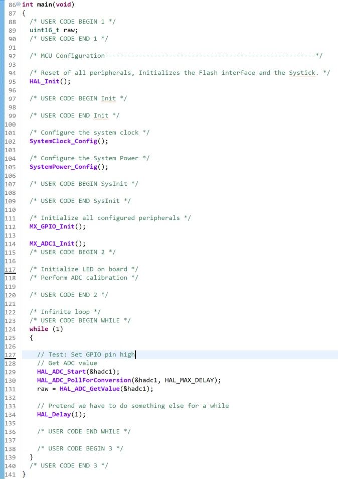

I don't think it needs extra code, as the code I run in my main.c is the same as the one in ST example project. When I debug I found my code is stuck in
HAL_ADC_PollForConversion(&hadc1, HAL_MAX_DELAY);
So I guess there must be some settings wrong/missed in my project. But I cannot figure it out as I followed the exact steps for ADC polling project.

Yes, I know. But when I delete these lines of code the ADC can still work. So I assume the issue is not there.
