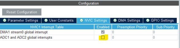

You didn't enable the NVIC for the ADCx

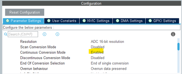

I would disable Continuous Conversion Mode.
