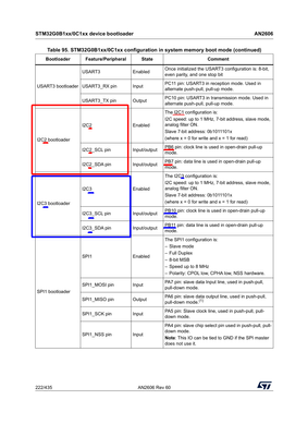

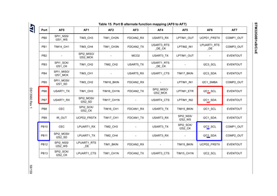

AN2606 - STM32G0B1 bootloader - I2C numbering discrepancy
waclawek.jan
KDJEM.1
Hi @waclawek.jan ,
I confirm the typo in AN2606,  for STM32G0B1, the Bootloader supports I2C1 and I2C2.
This issue is already reported  internally.
Internal ticket number: 164780 (This is an internal tracking number and is not accessible or usable by customers).
Thank you.
Kaouthar

KDJEM.1
Hi @waclawek.jan ,
Thank you.
Kaouthar

KDJEM.1
Hi @waclawek.jan ,
This issue is fixed in AN2606 Rev62.
Thank you for your contribution in STCommunity.
