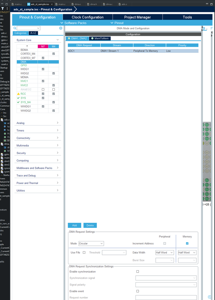

Hello team am Receving 16bit ADC conversion data to DMA in STM32H745i Disco in CubeIDE software. Here DMA interrupt is generating by default in software (i am disabled the interrupt in programming after that program counter is out of control) I dont want any ADC/DMA interrupt . DMA sholud receives the data contineously without any interrupt any solution for this ?

Some example:
Dudo
Thank you for" your HELP" i made the changes above and checked no output . I thought we Can't get WIthout the DMA interrupt . Can you discuss with your collegue or those who have highly known about this topic and Reconfirm about this please ??

Ok, so achieved your target with DMA. Interrupts You can still disable in the nvic label if you want:

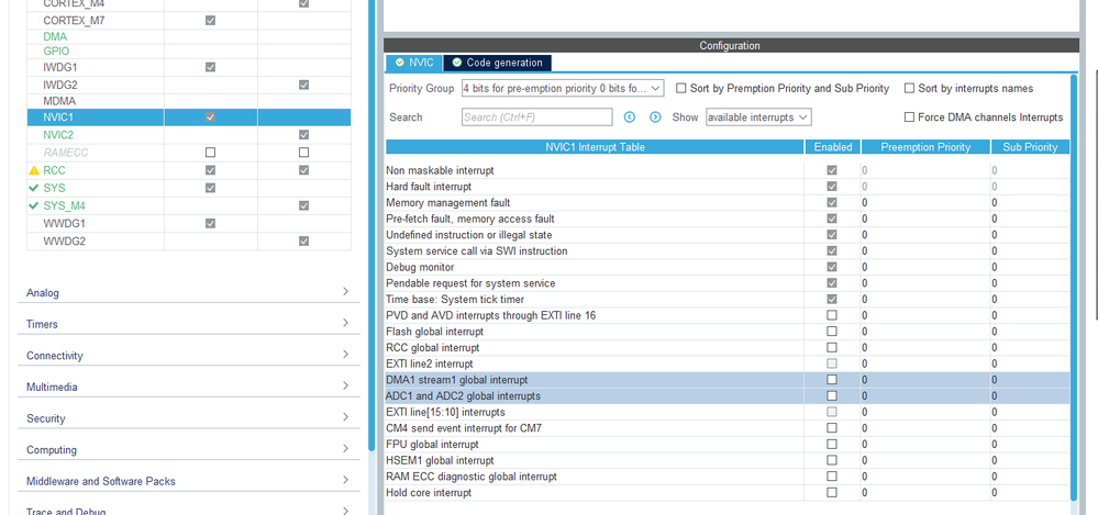

Thank you sir for your Help .Now You got the my point After disabling the NVIC for DMA i didn't get Any Data's Why ? (if you are achived this Can you share the Code/Zip file it would be very helpfull) . whenever DMA NVIC present that time i got the Data no issues working Fine.

DMA interrupts should not impact on data. Do You use callbacks?

You will learn a lot when reading the reference manual and the registers, then looking into the HAL functions to see what's going on.
So you might check what's going on in:
HAL_ADC_Start_DMA() shows you that DMA interrupts are enabled.
And the callback functions ADC_DMAHalfConvCplt() and ADC_DMAConvCplt() are set for DMA interrupt callbacks. Which do some housekeeping and then call the HAL ADC callbacks... (which shows us that this might not be the fastest solution...)
HAL_DMA_IRQHandler() which is called at each DMA interrupt.
It's mostly error handling, but also resetting (half-) transfer complete flags, and calling the (half-) transfer complete callback functions.
So all that might give you the hint that you need the DMA interrupts for that ADC DMA stream.
What you do in the HAL ADC callbacks is your thing.
Maybe set a flag to show that new data is available?
Anyway, when using ADC with DMA you do NOT need that ADC_get_value_whatever function, DMA is writing the ADC values directly into the specified buffer at DMA start.
Stop relying on CubeMX and HAL stuff alone. Start learning and thinking!
