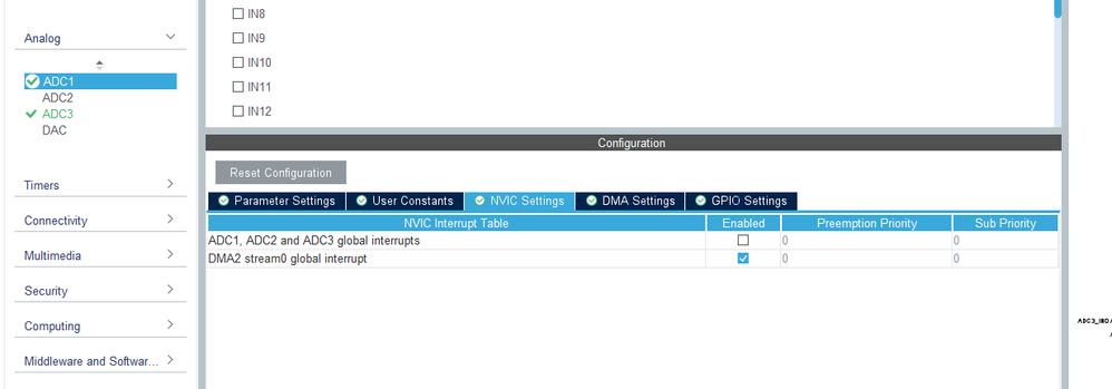

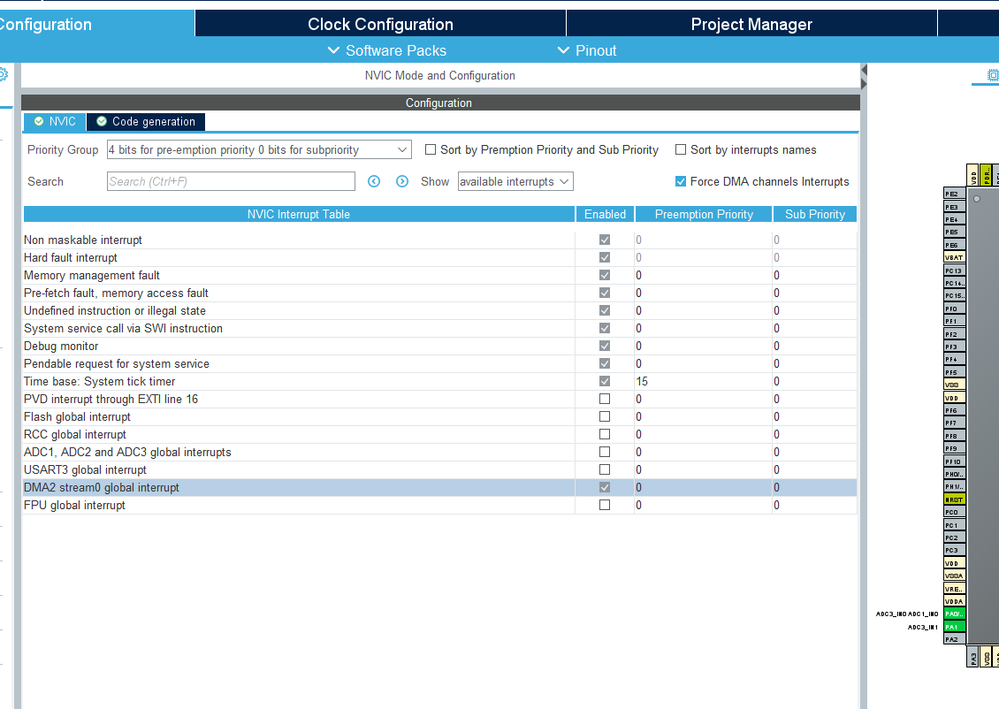

‎2023-04-20 3:20 AM - edited ‎2023-11-20 7:43 AM
If you use CubeMx you can uncheck options "Force DMA channels Interrupts":
‎2023-04-20 3:22 AM - edited ‎2023-11-20 7:43 AM
Also you can uncheck in ADCx settings but first you must uncheck as above "Force DMA channels Interrupts":
‎2023-04-20 3:51 AM
Thank you sir it could be very helpful . Am using CubeIDE i will check and i hope CubeIDE and MX nothing Much difference .
‎2023-04-20 4:59 AM
Yes i got the Above options and i did whatever you said after that i am calling a function HAL_ADC_Start_DMA(&hadc1,(uint32_t*)ADC_Value, ADC_BUFFER_SIZE); Before to while and tried inside the while also but i didn't Receive Any Data . Whats the issue ??
‎2023-04-20 5:04 AM
paste your code please
