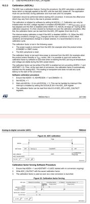

September 13, 2023
Hello @BrianB
Have you ensured that the ADC is off because as you can see in the user manual of the STM32CUBEG0:
  • Perform an ADC automatic self-calibration Calibration prerequisite: ADC must be disabled (execute this function before HAL_ADC_Start() or after HAL_ADC_Stop() ).Screenshot_2023-09-14-13-11-47-51.jpg
Also, in other boards, if the ADC work in a low frequency that can be a cause of error for HAL_ADCEx_Calibration_Start().
Best regards.
