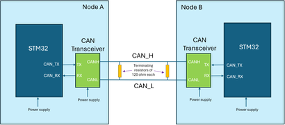

1- A sketch of your CAN bus. Like this:

PS: you didn't tell if you have connected another CAN node on the bus. If not. This is not the correct way to test the CAN interface in Normal mode. You need to use Loopback mode instead.
