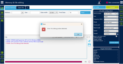

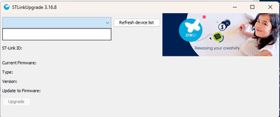

I can't upgrade the firmware because of it:
There is no item on the list

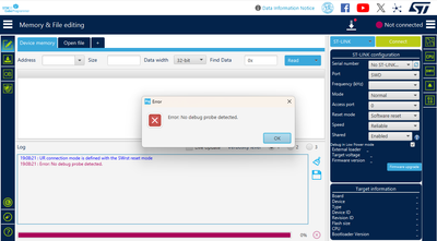

I attached my microcontroller to USB as usual (under W10). As you can see, I use SWD. But the programmer doesn't see it.

markpow
markpowAuthor
Senior
January 17, 2026
It's the same configuration that has worked under W10. The only change was from W10 to W11.
As you can see, there is no target voltage, and the LED doesn't blink when attached to the USB.
AScha.3
January 17, 2026
As YOU can see on the CubeProgrammer :
NO st-link connected.
So: you have a st-link at all ? connect it to USB.
