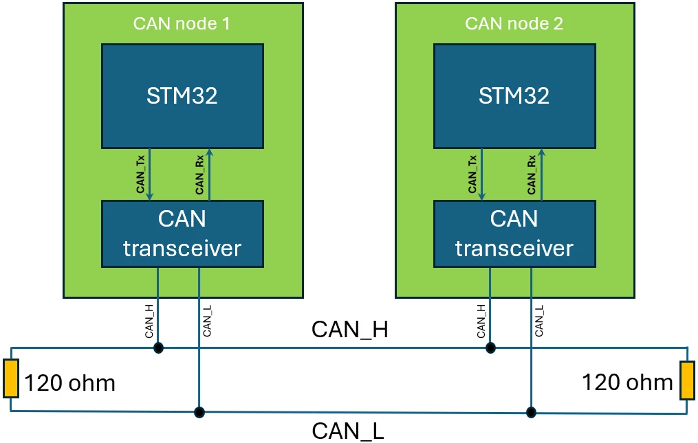

Figure 1 shows a typical CAN network topology where many CAN nodes are connected to the CAN network.
Figure 1. A typical CAN network topologyFigure 1. A typical CAN network topology

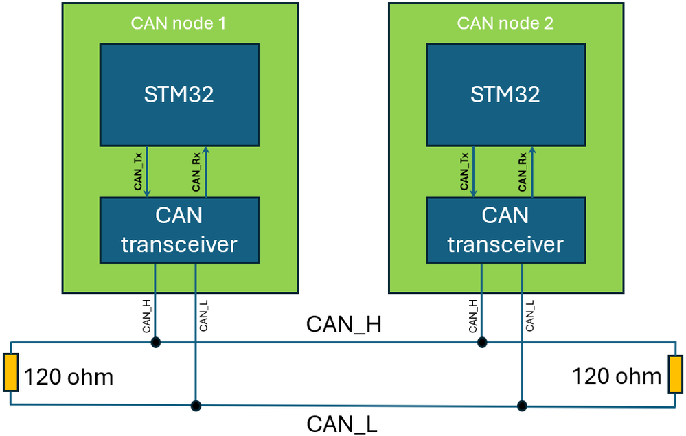

A CAN node is a CAN device intended to contain a CAN controller with a CAN transceiver. There is no leader-follower concept in the CAN protocol like SPI or I2C. Each CAN node connected to the CAN network is a leader and it is eligible to transmit and receive any frame on the bus with the respect to the CAN protocol. Each CAN node wins the arbitration phase continues to transmit its CAN frame. Others lose the arbitration and keep silent and listen to the bus till the end of the inter-frame space. A CAN node could be a controller, a sensor, an actuator, a CAN analyzer etc.
2. bxCAN in Normal mode on STM32
There are many modes supported by the bxCAN on STM32. Test modes (Silent mode, Loop back mode, Loop back combined with silent mode) and the Normal mode. The most used modes are the Loopback mode (see this article) and the Normal mode. The Normal mode is the mode where the CAN interface is intended to be used at the final application where many nodes (devices) will communicate together over a CAN network (shown in figure 1).  Software and hardware considerations need to be taken in this mode for a normal CAN operation. Figure 2 shows a minimum CAN bus required using STM32.
Figure 2. A minimal CAN bus using STM32 microcontrollerFigure 2. A minimal CAN bus using STM32 microcontroller
2.1 Hardware considerations

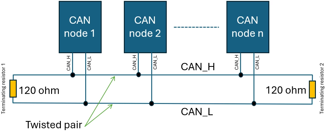

With the Normal mode, a complete CAN bus needs to be established. A complete CAN bus means a wire pair (differential voltage to transmit data): CAN_H (CAN High) and CAN_L (CAN Low) terminated by two resistors of 120 ohm at both sides of the bus to prevent signal reflections. The CAN communication needs at least two CAN nodes that should be connected to that CAN bus. The two wires should be twisted (shielded or unshielded) in the final application.
Figure 2 shows the minimum hardware required to establish a complete CAN bus with STM32. The reason to have a minimum of two nodes on the bus is the fact that a CAN frame sent by a node needs to be acknowledged by at least a receiver (a second node), no matter if it was the intended recipient of that CAN frame.  If only one node is available on the bus containing an STM32 and configured in Normal mode and transmits a CAN frame, it will not read a dominant bit in the acknowledgment slot supposed to be asserted by a second node (a receiver).  Therefore, an acknowledgment error is generated. So, it is not possible to use a CAN interface with only one CAN node in Normal mode to probe CAN_Tx output. For that case, CAN Loopback mode needs to be used (read this article).

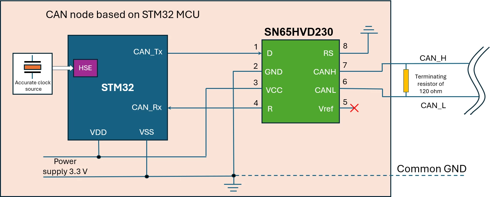

SN65HVD230 is a 3.3V transceiver and it is already used on many of ST evaluation boards, like STM3210E-EVAL, STM3221G-EVAL, STM32373C-EVAL, STM3240G-EVAL etc.

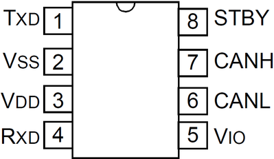

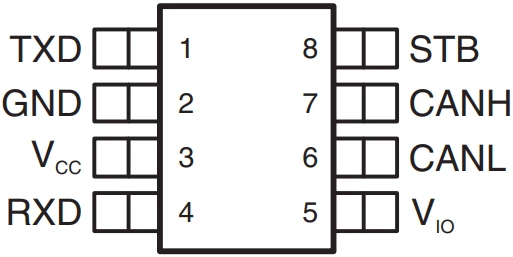

SN65HVDA540 is a 5V transceiver but it has a VIO pin for the voltage level shift.
Figure 4. SN65HVDA540 pinout with VIO pin (pin 5)Figure 4. SN65HVDA540 pinout with VIO pin (pin 5)

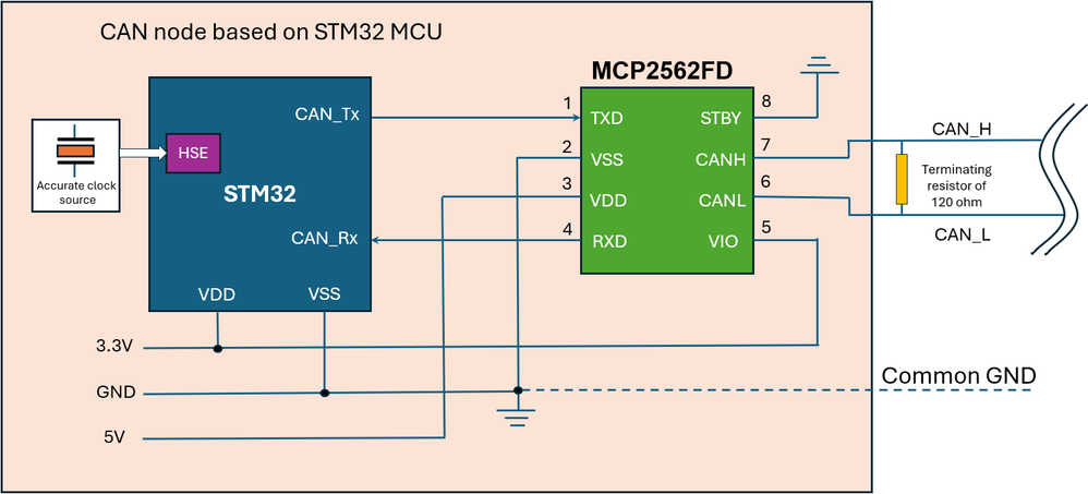

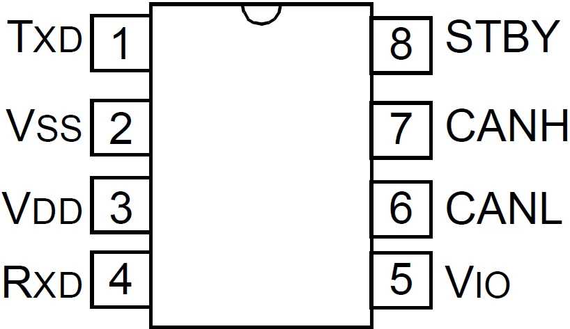

We can also use a CAN-FD transceiver for a CAN2.0 frame (see this FAQ). For that, another transceiver is recommended:
MCP2562FD which is a 5 V and CAN-FD transceiver that can reach up to 8 Mbps with a VIO pin:
Figure 5. MCP2562FD pinout with VIO pin (pin 5)Figure 5. MCP2562FD pinout with VIO pin (pin 5)
Figure 6 shows a hardware example of CAN node content using an STM32 and SN65HVD230 CAN transceiver.
Figure 6. CAN node based on STM32 and SN65HVD230 CAN transceiverFigure 6. CAN node based on STM32 and SN65HVD230 CAN transceiver

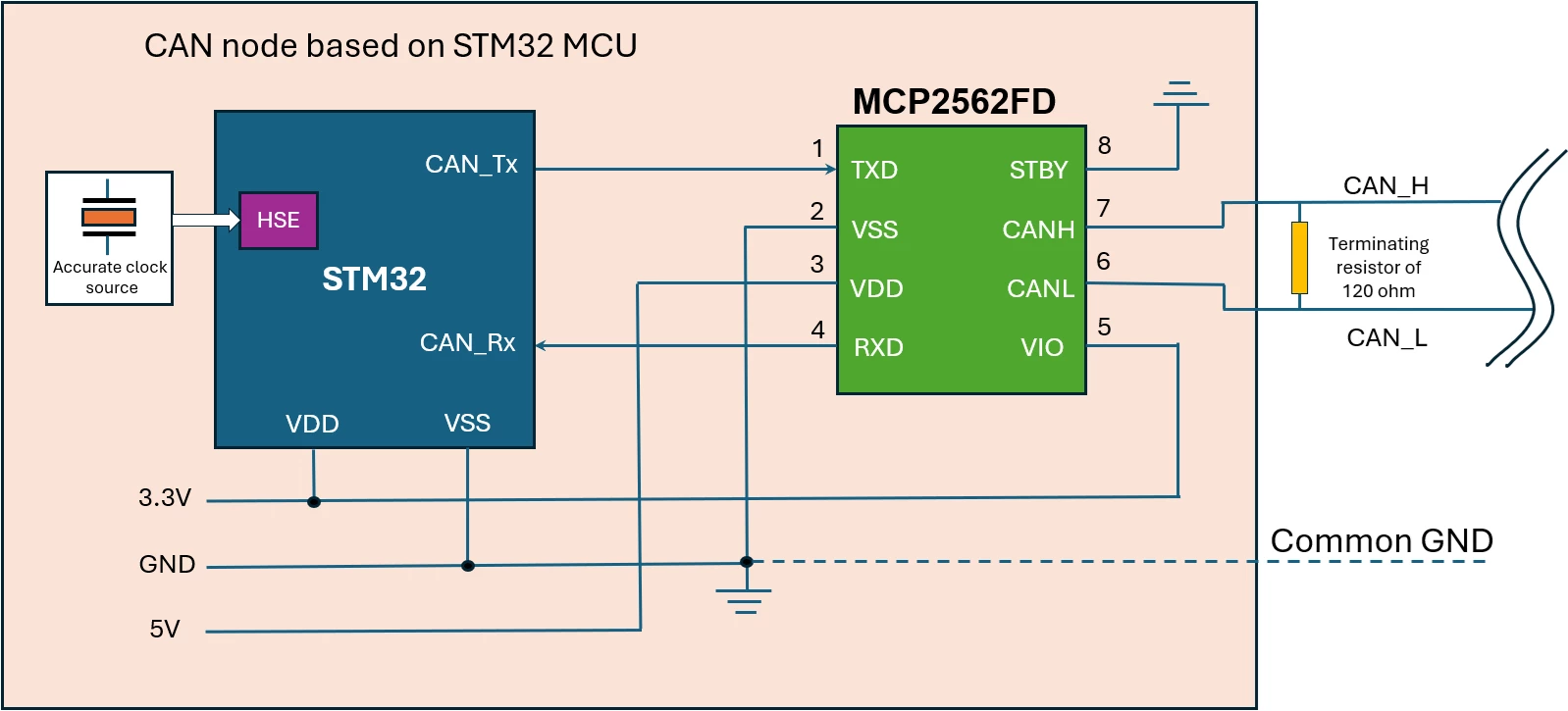

Figure 7 shows a hardware example of CAN node content using STM32 and MCP2562FD CAN-FD transceiver. In this case two power supplies are needed: 5 V and 3.3 V.
Figure 7. CAN node based on STM32 and MCP2562FD CAN-FD transceiverFigure 7. CAN node based on STM32 and MCP2562FD CAN-FD transceiver
Some transceivers have a pin called standby (STBY) other has RS pin (mode select). We will not enter details for their usage but for normal operation we need to connect these pins to the GND. Refer to the corresponding transceiver datasheet.
It is quite recommended to use an external and accurate clock source for HSE for CAN communication to prevent any communication issues. HSI and similar internal clock sources are based on RC cell which could be influenced by different factors (temperature/voltage/reflow effects/mechanical effects etc.). The source could be a crystal, a crystal oscillator, or any external clock source up to 50 ppm should be acceptable. See figures 6 and 7.

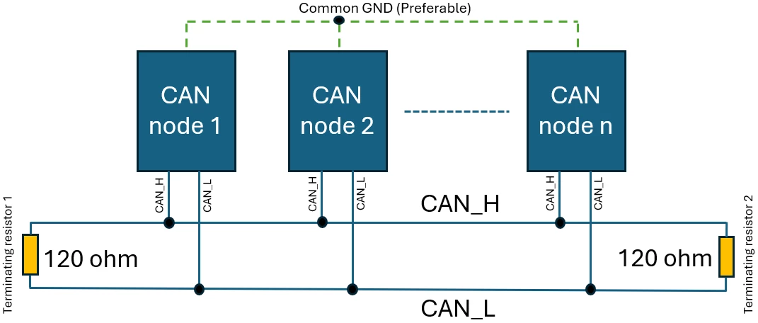

Even if the CAN uses two-wires propagating differential signals (for noise immunity), for more robustness, a common GND would be preferable due to some transceivers common-mode limitations. So, it is preferable to connect all nodes grounds together as shown by figure 8.
Figure 8. CAN with a common GNDFigure 8. CAN with a common GND

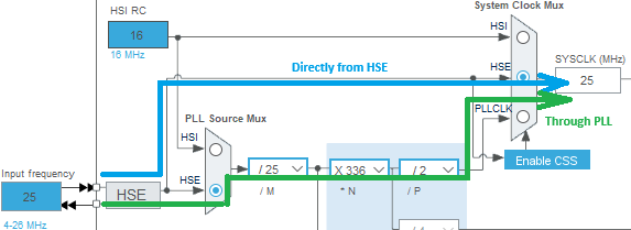

2.2.1 Clock configuration
As stated in the section 2.1 Hardware considerations, an external accurate clock source should be used for the CAN communication. For that, the system clock of STM32 should be fed from HSE either over the PLL or directly from the external source.  This could be with HSE in Crystal configuration (OSC_IN/OSC_OUT STM32 pins are used) or HSE in Bypass mode (only OSC_IN is used).
Figure 9 shows the two valid paths of the system clock to use CAN in Normal mode on STM32F407 using STM32CubeMX. For both paths, HSE is used.
Figure 9. System clock sourceFigure 9. System clock source2.2.2 CAN I/Os configuration
