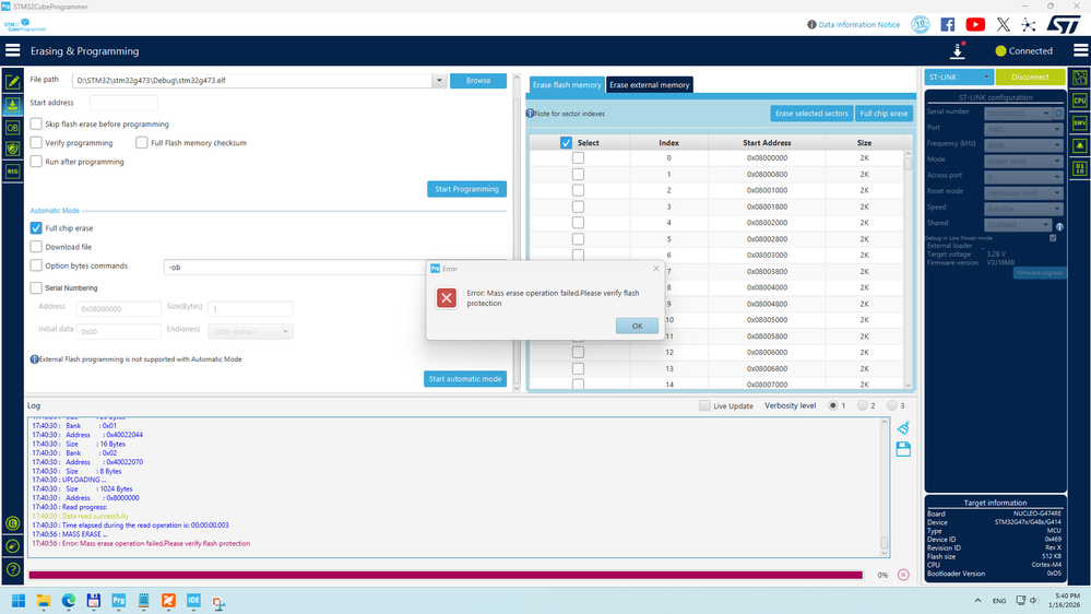

Now I cannot program or erase the MCU anymore.
I get the following errors:

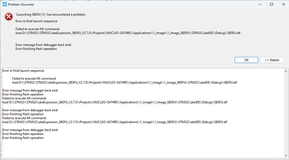

1.In STM32CubeIDE
'Launching SBSFU (1)' has encountered a problem.
Failed to execute MI command:
load ...\SBSFU.elf
Error finishing flash operation
2. In STM32CubeProgrammer
  • Full chip erase fails
  • Mass erase fails with error:
  • Error: Mass erase operation failed. Please verify flash protection
3.I also tried:
  • Full chip erase
  • Erase selected sectors
  • Hardware reset / power cycle
  • “Under reset” connection mode
  • Factory reset via STM32CubeProgrammer
→ All fail with flash protection–related errors.

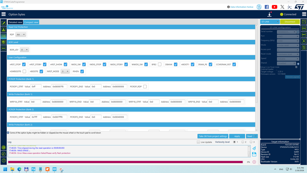

Option Bytes status
  • RDP = AA (Level 0)
  • PCROP and WRP were modified for SBSFU
  • After this change, the device seems to be locked and refuses erase/program operations

  1. Is it possible that I permanently locked the flash by misconfiguring WRP / PCROP while setting up SBSFU?
  2. Is there any recovery method to fully unlock or erase the MCU?

Jocelyn RICARD
Hello @RogueOne,
I notice that WRP START and END are all set to 0.
Could you try setting up Start values to 1?
Best regards
