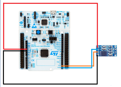

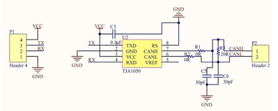

1. Hardware setup
To set up the hardware for communication, we need a transceiver that can convert the digital signals from the G0 MCU into analog signals that can be transmitted over the physical CAN bus. The transceiver also provides the impedance that defines the CAN_High bus and the CAN_Low bus. It also provides protection against voltage spikes and other electrical disturbances that can damage the microcontroller. Below is an image to clarify the connections between the Nucleo board and the transceiver's board:
Figure 1 - CAN transceiver hardwareFigure 1 - CAN transceiver hardware
The power should be connected via the 5 V available in the CN6 in the Nucleo board, as the TJA1050 requires a VCC = 5 V. Connect the FDCAN Tx and Rx pins from each board to the respective pins in the TJA1050 transceiver at connector P1. For this particular demo, the FDCAN1 TX/RX pins are the PC5 and PC4 pins, available in the connector CN9. Refer to the image below for clarification on the connections between the Nucleo and the transceiver's board:
Figure 2 - Hardware connectionFigure 2 - Hardware connection
A small note: The label marks on NUCLEO board indicates that these pins are related to the USART peripheral, but the FDCAN is also available in these pins.

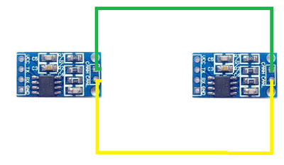

This connection should be replicated for the other Nucleo and transceiver set. Do not share the ground between the two sets. The connection between the transceivers should be made using the CAN_High and the CAN_Low pins, available in the connector P2. This establishes a physical connection between the two as we can see in the following image. By following these steps, we can set up the hardware for reliable communication.
Figure 3 - Connection between CAN transceiversFigure 3 - Connection between CAN transceivers

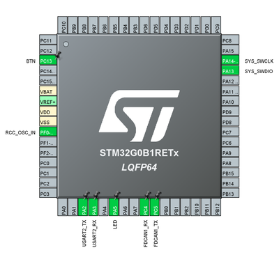

Let us start creating a project for the STM32G0B1RE in the STM32CubeIDE and set the following pinout configurations within the *.ioc file:
In the RCCs tab, enable the HSE in [BYPASS Clock Source]. This allows the application to use the onboard STLINK's 8MHz clock and change the clock settings in the [Clock Configuration] tab to make the HSE as the entry point for the PLL and the overall SYSCLK to 64 MHz
  • [Green LED] -  set PA5 as GPIO_Output
  • [User Button] - set PC13 as GPIO_Input
  • USART2
    Go to [Connectivity] and enable asynchronous mode with default parameter settings (115200 bit/s, 8 bits, no parity, and 1 stop bit.) Make sure that PA2 is the one selected as USART2_TX and PA3 as USART2_RX
  • FDCAN1

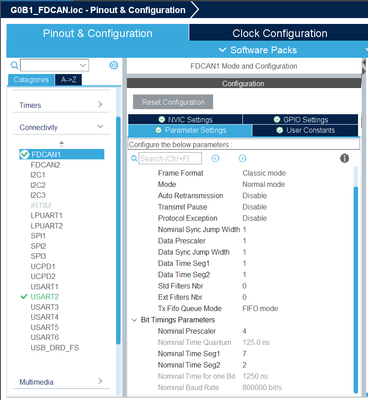

    In the [Connectivity] tab, locate the FDCAN1 and click the [Activated] checkbox. Make sure that PC4 is set as FDCAN1_RX and PC5 as FDCAN1_TX. It is important to note that the FDCAN protocol divides time into segments, and that this method is fully programmable in STM32CubeIDE.
    By defining the bit timing and synchronizing the transmitter with the receiver, we can ensure reliable communication between the two devices. This demo is selected to 800 Kbit/s, but this is very arbitrary and should be adjusted to the application needs. To set the baud rate, go to [Parameter Settings] and use the values shown in the image below to set the FDCAN baud rate to 800 kbits/s, for example.
Figure 4 - FDCAN baudrate settingsFigure 4 - FDCAN baudrate settings
For this example, we transmit data on the FDCAN bus by polling and receive it through interrupts. While the peripheral can use up to 2 FIFOs to handle data reception, we just need the FIFO0. In the [Parameter Settings] tab, navigate to [NVIC Settings] and enable the option FDCAN1_IT0.
After completing all these steps, your microcontroller configuration should look like this:
Figure 5 - MCU pin allocationFigure 5 - MCU pin allocation

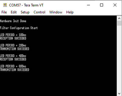

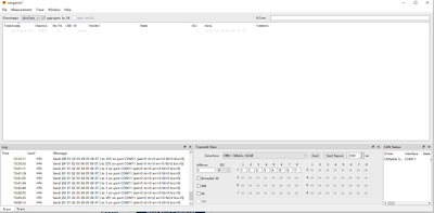

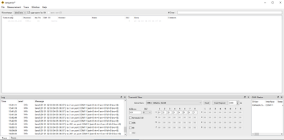

3. Results

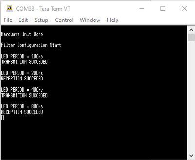

Enter in a debug session or program the board and open a virtual COM port terminal on your computer. When the user presses the button on one board, the LED status changes. The new value is transmitted over the FDCAN bus to the other board, which receives the message and updates its ubKeyNumber variable to match the value received. This ensures that both boards are synchronized and display the same LED status based on sharing the value of ubKeyNumber.
To verify the success of the FDCAN communication between the two boards, we displayed messages in a virtual COM terminal as an interface. These messages indicated whether the transmission and reception of data were successful or not.
In this example, the user can press the button to alternate transmission and reception between the boards. The results of this process are shown in the images below:
Figure 6 - Demo validationFigure 6 - Demo validation
Figure 7 - Demo validationFigure 7 - Demo validation
