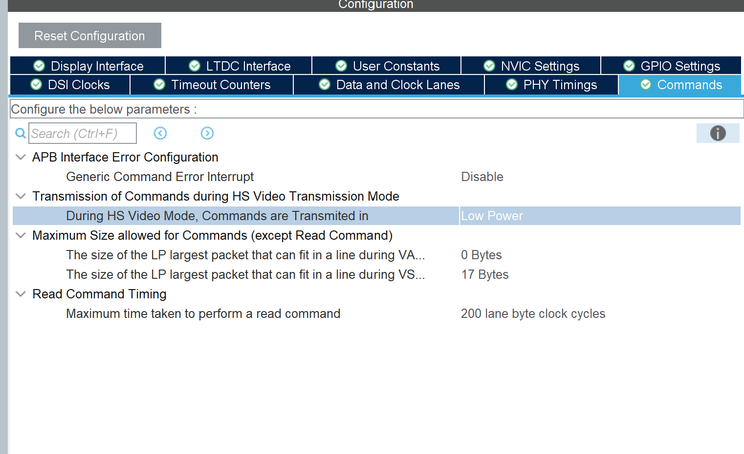

@RobNewbury  I am working on a project using STM32U5G9- DK1 DSI Host MIPI one lane to drive SH8601 based display. I am still not able to work in video mode or in adaptive command mode. So far, I only can set it to work in APB command mode which send images to GRAM at very slow data rate.
1. If configure DSI host in video mode or adaptive command mode and  send initialization command to display in escape mode,  when using HAL_DSI_ShortWrite() and HAL_DSI_LongWrite() to send initialization command to display, it will report  PE0:  escape entry error from lane 0. Thus, can't initialize display.
2. If first configure DSI host in APB command mode,  then change DSI Host to be in video mode or adaptive command mode,  display can be initialized properly. But the image data can't be sent over to display. The clock signal waveform is very good, but no data shown on data0 lane.  I have checked status of LTDC , DSI host and DSI wrapper, they have been enabled.
I saw your project is initialize display in LP mode and send image data in HS mode. Would you like to share how to make reconfiguration successfully? Thank you very much.

@RobNewbury ,Thank you for your sharing!  I tried start DSI -> start LTDC-> initial display in LP mode, The display can't be initialized.  I guess F4 might be different from U5.
In your code, DCS long write, DCS short write, generic long write and generic short write are LP mode disabled, i.e. they are all set  to HS mode.  Is the above code for initial display in HS mode?
Are you using burst video mode? or other mode?
@Kelly3 I'm using HAL_DSI_ShortWrite() and HAL_DSI_LongWrite(), I'm using these in LP mode, I'm not aware that these functions are LP mode disabled, I am definetly using LP mode and they are working for me?

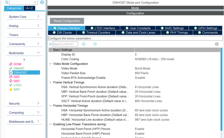

I'm using burst video mode, below is my DSI set up. Check that the VACT value is correct for your display. My other display is 720 pixels and I had the VACT set to 800 pixels, the display wouldn't initialise until I changed VACT to 720. I had thought that the VACT should include VS period in pixel clock cycles, however that is not the case.
Another mistake I had made was to initialise the display to RGB888 and the DSI to RGB565.
I hope that you get your display working.

I am using 454x454 display. VACT is set to be 454 as in main.h file.
in main.c file, the display initial function is called  inside function MX_DSIHOST_DSI_Init(). It can initialize display. command 0x23, all pixel on is called in the display initial function so that I know whether display can be initialized. I can probe HS data transfer on data lane 0.but no image displayed on display.
in main-1.c file, the display initial function is called  inside function MX_LTDC_Init() following your instruction. Yet, display can't be initialized.
I have been working on this project for a long time, it is pretty frustrating since following user manual RM 0456 procedure does not work.
Hi, I took a look at your code. I had similar issues with my display that didn't have TE pin nor GRAM so I had to set it up in video mode. Switching from cmd to video mode got me nowhere. First thing you need and you already have is to allow commands in video mode. Leave your code in dsi host as is generated. In your ltdc initialisation right before starting ltdc, start dsi, init your display using short/long commands. After that power up display and let ltdc start.  I can't remember all steps but thats the structure of initialisation that solved init part so you get something on screen instead of black screen
