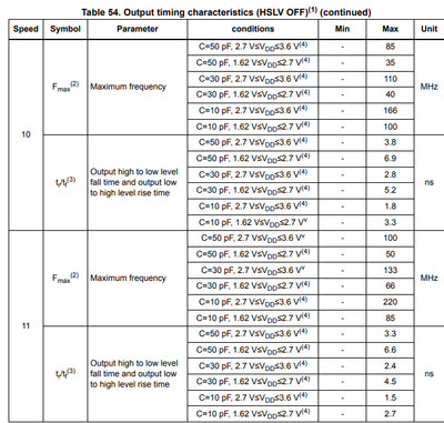

Gyessine
Hello @JinJin
If  I understood your question right
based on your product Datasheet table 54
if you choose "VERY HIGH" as GPIO maximum output speed you can reach toggling times of nano seconds, but you will need a very clean implementation
Hope that answered your question
