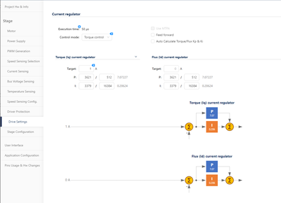

Hello @seif1,
Firstly, the language of the Community is English as mentioned here.
You can also tune the Torque PID values to have a more reactive response (by increasing the integral part for example):
If you agree with the answer, please accept it by clicking on 'Accept as solution'.
