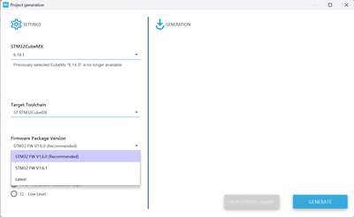

Hi, Community.
When I try to generate an IDE project from the MotorControlWorkbench project I inherited, an error occurs.
I checked both cases where a previous IDE project existed and where only the stwb6 file existed, but neither worked.
The IDE, MX, and MotorControlSDK are installed.
Are there any special steps required to generate an IDE project on another PC?

On stwb6_only.log, "Target STM32 FW : Latest", and for old_ide_project_exist.log, "Target STM32 FW : 1.6.0".
Does FW package 1.6.0 available on your setup?

FW package
1.6.0 and 1.6.1 seem to be available.
