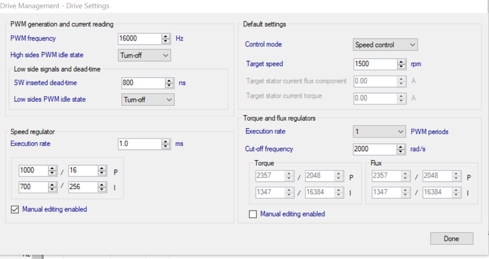

Hello everyone,
I am running into a problem with the STSPIN3202 evaluationboard. I cant get my BLDC motor A2212 930KV 15T with sinusoidel BEMF to spin.
I have tried 6 step sensorless and FOC sensorless. In case of 6 step the motor keeps buzzing stationary so it is wat i think a startup problem. With FOC it just gives beep and nothing more(I didnt forget to change the jumpers according to https://www.st.com/resource/en/user_manual/um2278-getting-started-with-the-stevalspin3202-evaluation-board-advanced-bldc-controller-with-embedded-stm32-mcu-stmicroelectronics.pdf ).
For both methods I took some example code from the MC workbench and changed some motorparameters and the Vbus voltage.
V-bus voltage is 11V

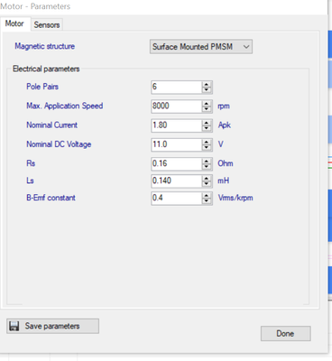

For the Motorparameters I couldnt find a datasheet so I had to determine them.
The pole pairs parameter is determined by spinning the motor with my hand. Full rotation counted (12 steps so 6 pairs).
The board is powered with 11V.
The Rs and Ls are measured with a multimeter and a LCR meter.
The BEMF constant I calculated: 930KV, 930rpm/V = 0.0011V/rpm 1.1V/krpm
1.1/(2 * squareroot(2)) = 0.38 Vrms/krpm.

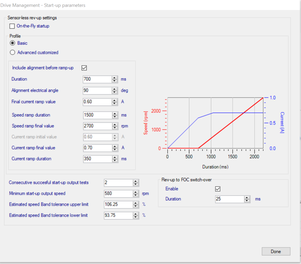

On the startup parameters I didnt change much just default from the example BullRunning Motor 1700kV.
Drive settings are also all default

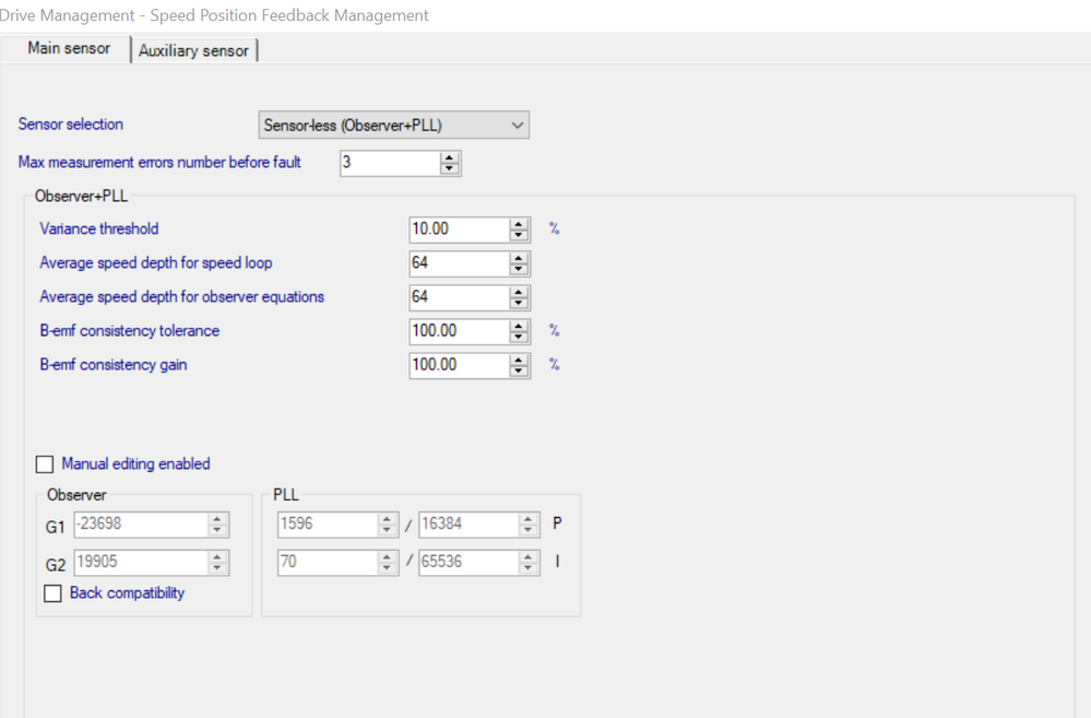

Speed sensing is also sensorless
I have tried both MC WB(5.4.8 and the 6.2.1) and what I find remarkable is that in the 5.4.8 version the speed monitor wont work it just freezes. By the way I am new to BLDC motors.
If someone could tell me what I am doing wrong, I would appreciated that.

As mentioned in our MC Wiki page, the number of rotor stable positions in one mechanical turn represents the number of pole pairs.
If you are measuring Ls and Rs between two phases you have to divide these values by two. Workbench parameter is between phase and neutral.
