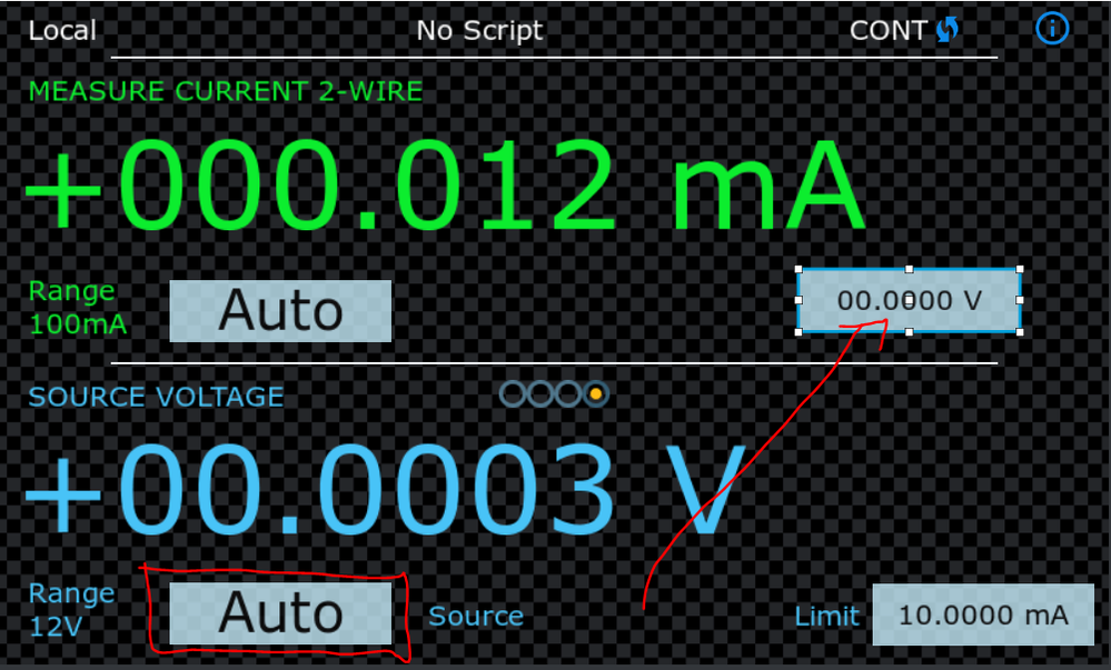

I'am protoyping a GUI on a STM32F469I-Disco board and encounter the "feature" that buttons in the lower area of the canvas will not trigger when touched (e.g. the red circled "Auto"). Strangely when moving these buttons (e.g. "00.000V") to the upper area without changing anything else the suddenly work????
Of course my first suspect was the FT6xxx touch controller chip, so I debugged into the STM32TouchController::sampleTouch(int32_t& x, int32_t& y) function. I confirmed that the touch controller worked as designed delivering proper coordinates on every touch (origin in the upper right corner, x increasing down, y increasing to the left)
 As of now I've no clue where to look, help appreciated!

Freddy15
Mea culpa, mea maxima culpa!!
I used a swipe container in the lower area, which masked the buttons -> oooops
Problem recognized and solved
