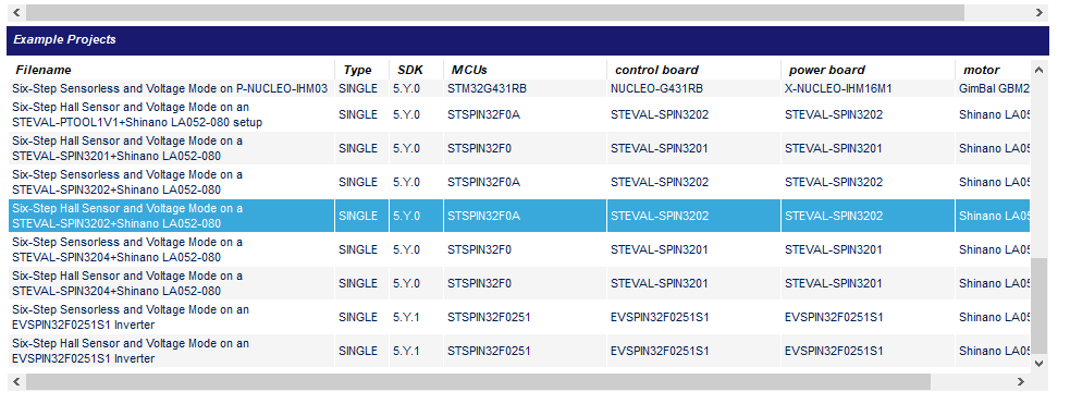

I suggest to clean the folder and recreate the project from scratch starting from loading the example from 5.Y.4 as follows:
1- in the 5.Y.4 click on the example you are interested in
0693W00000Nqd6OQAR.png 2- After reading, close the readme.txt file and the warning message
3- Click on "Save As" and save the project without renaming it
0693W00000Nqd6xQAB.png4- Click on project generation icon, select the toolchain and click UPDATE
0693W00000Nqd7lQAB.png5- generation process should start with the proper library version (5.Y.4-Full)
0693W00000Nqd8FQAR.png6- Load the project in your development environment and open the file stm32f0xx_mc_it.c where you have to replace the function like in my previous post
0693W00000Nqd9DQAR.png7- build and download the project to the board (or launch the debug mode...)
0693W00000NqdA6QAJ.png8- Open the Motor Pilot, load the defaultApp_6STEP and connect with Speed 115200
Regards
Alessio

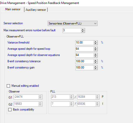

The errors starting to pop up when I select Sensorless + PLL or other Sensorless in Speed sensing:
0693W00000NqeqSQAR.pngC:/ST/Projects/6S_STEVAL3202_SL_VM/Src/mc_config.c:47:43: warning: initialization of 'short unsigned int' from 'void *' makes integer from pointer without a cast [-Wint-conversion]
  47 |  .enPWMx[0].enPWMx_GPIO_Pin      = NULL,
C:/ST/Projects/6S_STEVAL3202_SL_VM/Src/mc_config.c:47:43: note: (near initialization for 'Motor_Device1.enPWMx[0].enPWMx_GPIO_Pin')
C:/ST/Projects/6S_STEVAL3202_SL_VM/Src/mc_config.c:49:43: warning: initialization of 'short unsigned int' from 'void *' makes integer from pointer without a cast [-Wint-conversion]
  49 |  .enPWMx[1].enPWMx_GPIO_Pin      = NULL,
C:/ST/Projects/6S_STEVAL3202_SL_VM/Src/mc_config.c:49:43: note: (near initialization for 'Motor_Device1.enPWMx[1].enPWMx_GPIO_Pin')
C:/ST/Projects/6S_STEVAL3202_SL_VM/Src/mc_config.c:51:43: warning: initialization of 'short unsigned int' from 'void *' makes integer from pointer without a cast [-Wint-conversion]
  51 |  .enPWMx[2].enPWMx_GPIO_Pin      = NULL,
C:/ST/Projects/6S_STEVAL3202_SL_VM/Src/mc_config.c:51:43: note: (near initialization for 'Motor_Device1.enPWMx[2].enPWMx_GPIO_Pin')
First the warning above (pops up even with hall sensors selected but can be ignored)
With Sensorless selected:
C:/ST/Projects/6S_STEVAL3202_SL_VM/Src/register_interface.c:235:13: warning: implicit declaration of function 'STO_PLL_GetObserverGains' [-Wimplicit-function-declaration]
 235 |       STO_PLL_GetObserverGains(stoPLLSensor[motorID], &hC1, &hC2);
C:/ST/Projects/6S_STEVAL3202_SL_VM/Src/register_interface.c:235:38: error: 'stoPLLSensor' undeclared (first use in this function)
6 step can be sensorless right?

examples cannot be customized through the MCSDK GUI. So you cannot choose sensorless and regenerate the project.
If you want to run the sensorless algorithm you need to open the corresponding example in the example projects list, repeat the above steps and customize the algorithm parameters like shown in section 4.2 of the UM2916 I attached to my previous post

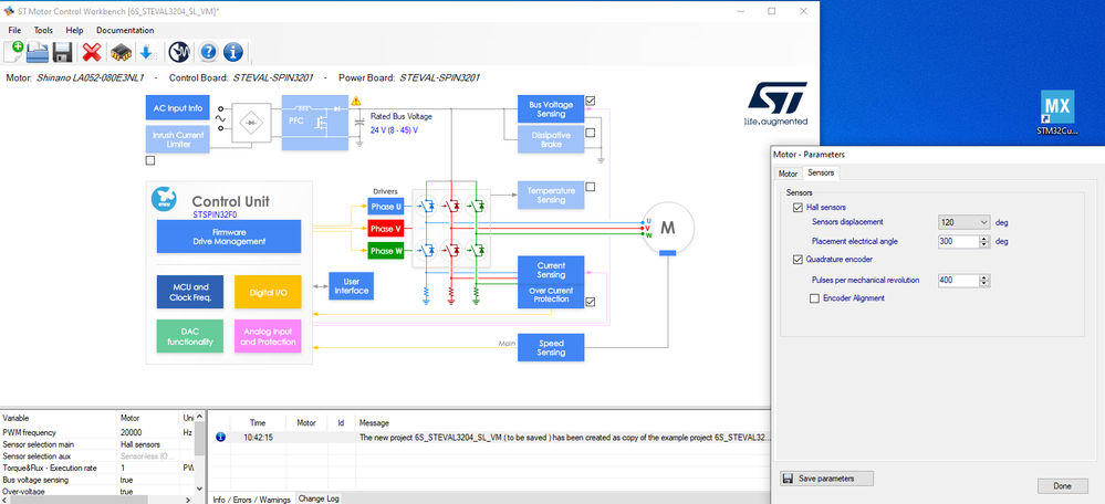

I am opening a new project in 5.Y.4.
It is sensorless:
0693W00000NqsA6QAJ.png When it is just open, It has Hall Sensors for the Motor and in Speed Sensing.
Am I not allowed to change it to sensorless?
Motor and Speed sensing in sensorless example should be sensorless right? Or I just need to ignore these settings?

disregard those setting. If you opened the sensorless example it will run in this way despite the configuration reported in the GUI
Alessio

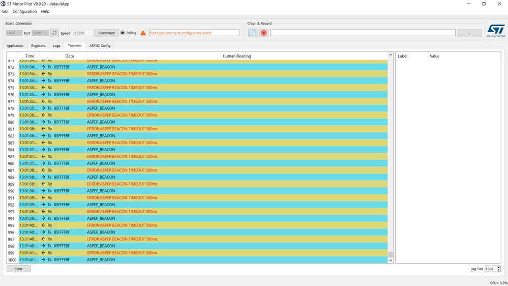

Now, I have made many attempts to develop FOC with the same board Steval-Spin3202, but couldn't succeed. For that, I tried developing the code from scratch with MCSDK-Y. All I get is the following:
0693W00000SvpUrQAJ.pngNote that, when I try to change the code "void SysTick_Handler(void)" I get errors due to some variables or functions not declared. Maybe that piece of code you tell us to change only apply for 6step development and not for FOC.
Please, can you write a post with detailed steps, similar than before, but now for FOC and with the same board Steval-Spin3202?
