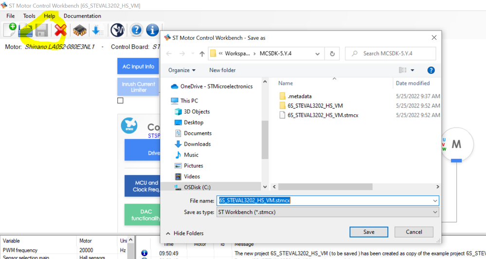

Best answer by ADAVE.1
Hi Edward,
the errors raised are related to FOC functions that should not be there in the six-step project. You are likely missing something in the generation process.
I suggest to clean the folder and recreate the project from scratch starting from loading the example from 5.Y.4 as follows:
1- in the 5.Y.4 click on the example you are interested in
0693W00000Nqd6OQAR.png 2- After reading, close the readme.txt file and the warning message
3- Click on "Save As" and save the project without renaming it

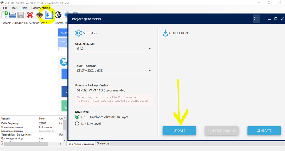

0693W00000Nqd6xQAB.png4- Click on project generation icon, select the toolchain and click UPDATE

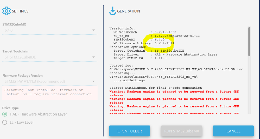

0693W00000Nqd7lQAB.png5- generation process should start with the proper library version (5.Y.4-Full)
0693W00000Nqd8FQAR.png6- Load the project in your development environment and open the file stm32f0xx_mc_it.c where you have to replace the function like in my previous post
0693W00000Nqd9DQAR.png7- build and download the project to the board (or launch the debug mode...)
0693W00000NqdA6QAJ.png8- Open the Motor Pilot, load the defaultApp_6STEP and connect with Speed 115200
Regards
Alessio

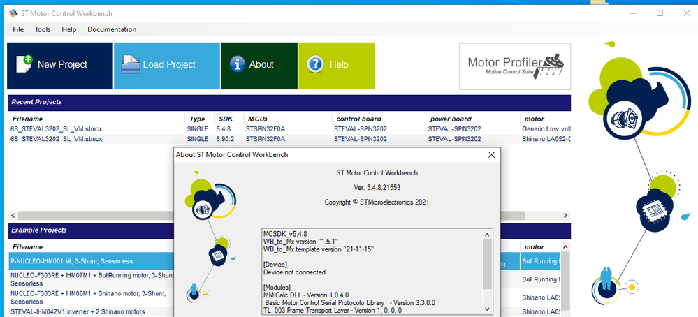

EShaw.1
EShaw.1Author
May 21, 2022
Hi Alessio,
Thanks for the response.
I am using MCSDK_v5.4.8.
MCSDK 5.Y.4 does not work with STEVAL-SPIN3202. One of your colleagues suggested not to use MCSDK 5.Y.4 but MCSDK_v5.4.8 instead.

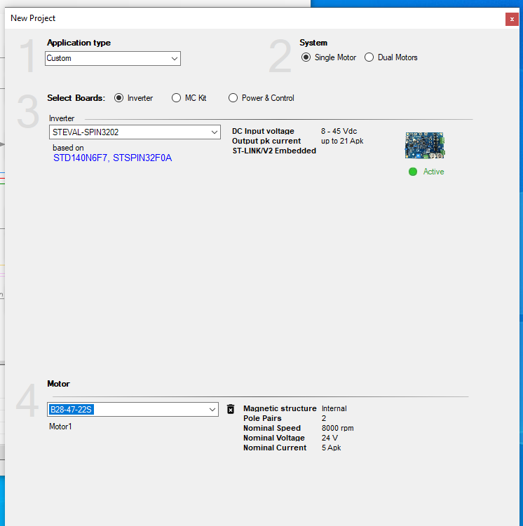

0693W00000NqOekQAF.pngThe name of the project - I just changed generic name to 6S_STEVAL3202_SL_VM. Sorry for confusion.
This project was created by ST Motor control Workbench:
File\New Project
Motor B28 - small brushless sensorless inrunner.

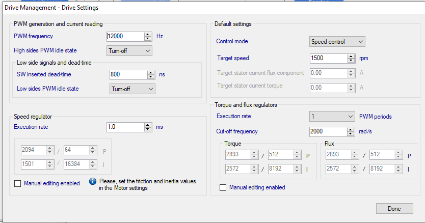

Changes to settings:
1) Motor Parameters
2) Overcurrent protection disabled (Tick on main screen and in Analog and input protection) (As I was unable to get it working with protection activated)
3) Speed setting - Sensorless (Oserver+PLL)
4) PWM Freq changed to 12000Hz
5) Control mode- Speed control
Could you please suggest another way of using some example for STEVAL-SPIN3202?
Regards,
Edward.

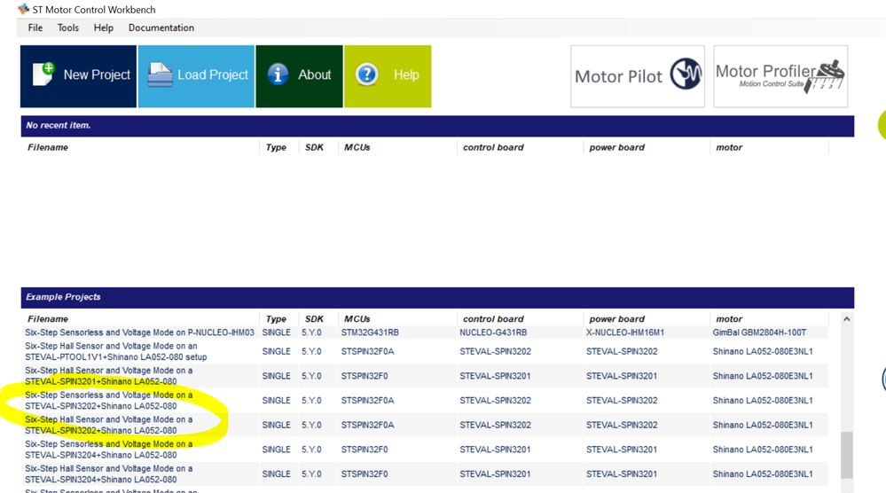

ADAVE.1
May 23, 2022
Hi Edward,
it's not clear to me why you have been suggested to use 5.4.8 and if you created the project from scratch (like I see from the image above) or you just load the example of the STEVAL-SPIN3204 (that is compatible with STEVAL-SPIN3202).
Please be aware that if you create a project from scratch in 5.4.8 you are generating a FOC project.
On the other hand, if you load the example you are not able to customize it from the main interface but you have to look for the configuration parameters inside the generated code.
Since SDK 6.0 doesn't currently support F0, I would recommend to use 5.Y.4 and load the example "Six-Step Sensorless and Voltage Mode on a STEVAL-SPIN3202+Shinano LA052-080". Save it WITHOUT renaming the project and generate the code by clicking the UPDATE button. In order to customize the parameters and where to find them into the code, I suggest you to read carefully the attached doc.

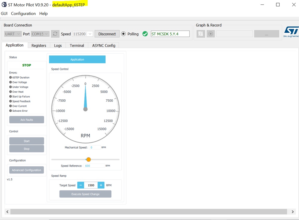

EShaw.1
EShaw.1Author
May 24, 2022
Hi Alessio,
Thank you again.

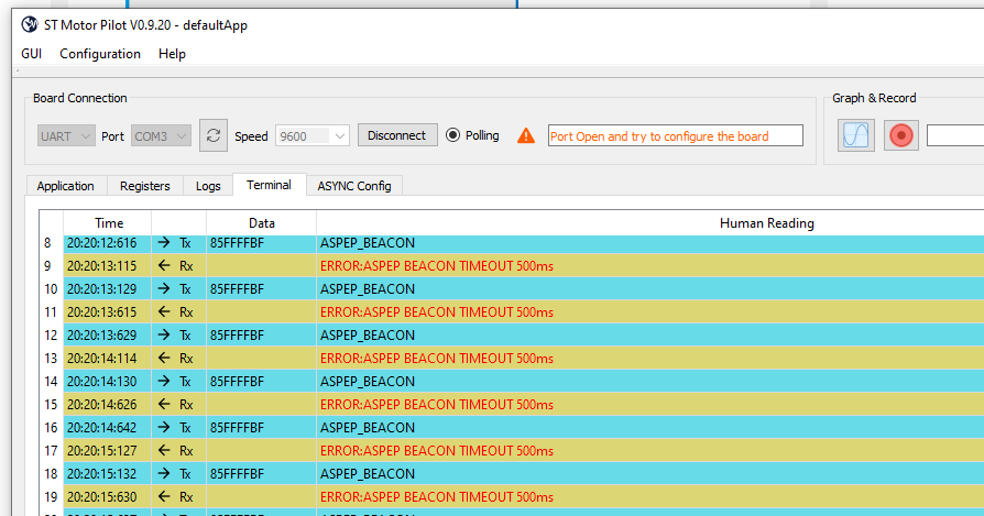

The reason why your colleague suggested that STEVAL-SPIN3202 does not work with 5.Y.4 is that after uploading the project, It is impossible to connect to it with Motor Pilot:
0693W00000NqZ5qQAF.pngThat is why he suggested using 5.4.8 instead.
If you could suggest how to fix connection issue, it would be great.
I'll download the example of the STEVAL-SPIN3204 in 5.4.8 as you suggested and will keep you posted:).
Regards,
Edward.
ADAVE.1
May 24, 2022
Hi Edward,

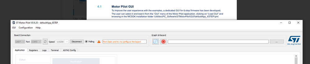

Please read section 4.1 of the document I attached in my previous post.
You need to select the proper "qml" file in the MotorPilot installation folder.
Regards
Alessio

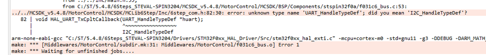

EShaw.1
EShaw.1Author
May 24, 2022
After downloading the example of the STEVAL-SPIN3204 in 5.4.8
This error pops out. May be board STEVAL-SPIN3202 is not that compatible with STEVAL-SPIN3204?
What and where can be tweaked?
ADAVE.1
May 24, 2022
Like I wrote in my previous post, I recommend to use 5.Y.4

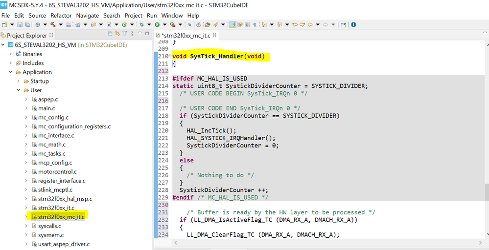

EShaw.1
EShaw.1Author
May 24, 2022
same result. 5.Y.4. Correct GUI. No connection. Not on 115200 nor on 9600 Baud

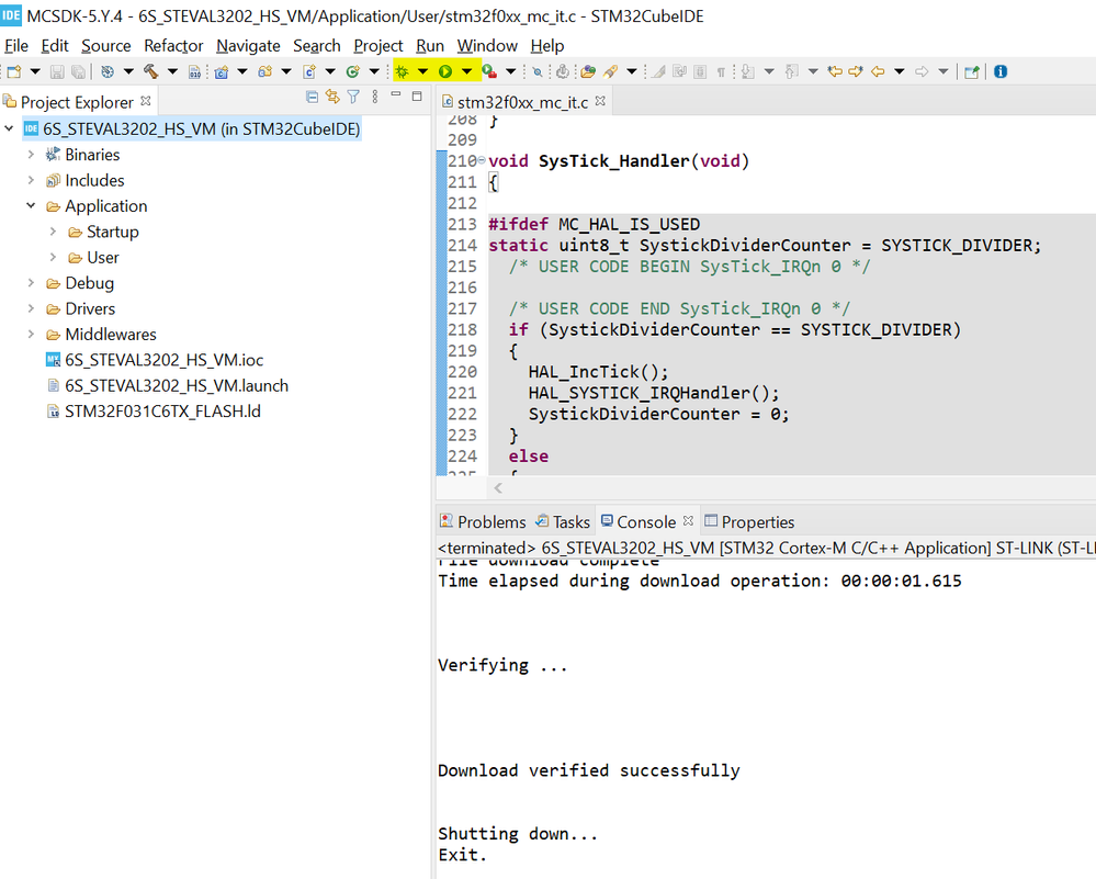

ADAVE.1
May 24, 2022
Hi Edward,
please try replacing the function "void SysTick_Handler(void)" in the file "stm32f0xx_mc_it.c" with the following lines of code:
#ifdef MC_HAL_IS_USED
static uint8_t SystickDividerCounter = SYSTICK_DIVIDER;
 /* USER CODE BEGIN SysTick_IRQn 0 */
 /* USER CODE END SysTick_IRQn 0 */
 if (SystickDividerCounter == SYSTICK_DIVIDER)
 HAL_IncTick();
 HAL_SYSTICK_IRQHandler();
 SystickDividerCounter = 0;
 else
 /* Nothing to do */
 SystickDividerCounter ++;
#endif /* MC_HAL_IS_USED */
 /* Buffer is ready by the HW layer to be processed */
 if (LL_DMA_IsActiveFlag_TC (DMA_RX_A, DMACH_RX_A))
 LL_DMA_ClearFlag_TC (DMA_RX_A, DMACH_RX_A);
 ASPEP_HWDataReceivedIT(&aspepOverUartA);
 else
 /* Nothing to do */
 /* USER CODE BEGIN SysTick_IRQn 1 */
 /* USER CODE END SysTick_IRQn 1 */
 Motor_Device1.uw_tick_cnt++;
 MC_RunMotorControlTasks();
 /* USER CODE BEGIN SysTick_IRQn 2 */
 /* USER CODE END SysTick_IRQn 2 */
I remind you to save the project without renaming it and generate the code by clicking the UPDATE button in the project generation window of the MCSDK .
Hope this solve your issue in the 5.Y.4 release.
