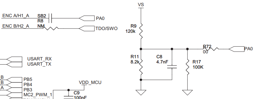

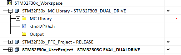

which user AC6 project can be used in combination with STEVAL_IHM042V1?
I would like to use the STEVAL_IHM042V1 to run two motors with hall sensors
Is it: \Web\Project\AC6\STM32F30x_UserProject -> config STM32303C-EVAL_DUALDRIVE?

Posted on November 10, 2017 at 10:30
Hi Gerber,
I tried to generate the MCWB project starting from yours, but looks like the STEVAL-IHM042V1 doesn't support a dual-motor driving where both motors use Hall sensors and 3-shunt sensing.
In fact the Hall3 input of motor 2 is shared with one of the current sensing input:
And Hall1 of motor 1 is shared with voltage sensing.
You should change your target topology if you want to use this board.
In any case, I attach you a WB projecthighlighting all these problems.

Posted on November 13, 2017 at 15:22
I used the project you shared as reference. However, using single shunt topology no conflicts are generated.
Building theFOC lib with the attached setupand using the dual-drive configuration I obtained the attached binary
I had no chance to test it because I have no suitable board.
