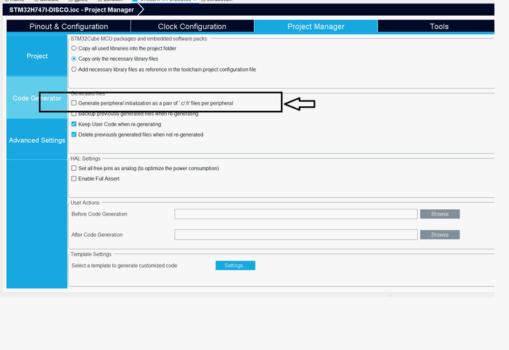

I am working on a project with TouchGFX Designer and STM32CubeMX. Like you said I can flash the code generated directly from TouchGFX Designer without any problem. However, when I try to integrate my own custom code into the project, I face an issue right at the beginning.
Specifically:
  • If I enable a certain setting(below image) in CubeMX and then generate the code, the LCD fails to initialize.
  • If I disable that setting and regenerate the code, the LCD initializes correctly and everything works.
I will share two project files
  • One with the setting enabled (LCD not working).
  • One with the setting disabled (LCD working).
Could you please help me understand the difference between these two cases and why the LCD initialization fails when the option is enabled?
I see. This option splits out the code that CubeMX generates for initialization into separate files for each peripheral.
The reason that this does not work is that the setting does not preserve user code, which is used to, among other things, initialize the display.
If you strongly prefer to split the code, you can make it work. In that case, you should copy main.c before enabling the setting, and then after regenerating code with the setting enabled, go through the original main.c and place the code from each user code section throughout that file into the correct place in the new project structure.
