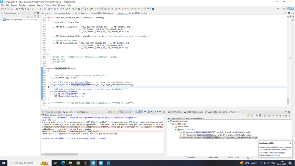

Is that means FOC algorithm is not meant for drone motors?
And, yeah I have tried that 6-step algorithm but its generated error as below,
multiple definition of `TIM2_IRQHandler'multiple definition of `TIM2_IRQHandler'
as multiple definition of `TIM2_IRQHandler'. While checked further the `TIM2_IRQHandler' function has defined in two different files.
1. in the esc.c
2. in stm32f30x_mc_it.c
If possible kindly help me to merge this function if it is have to..
Or any other possible solutions.
Thanks,
Best Regards,
Santhosh.
STuser2
Senior III
I can help to compile the code but not sure of the functionality or i have not got in details of the interrupt handler.
Comment this section of the code
// #define PERIOD_COMM_IRQHandler TIM2_IRQHandler
, it is in the file parameters_conversion_f30x
it will compile. You can call in TIM2_IRQHandler(void) the below function
PERIOD_COMM_IRQHandler();
as below
void TIM2_IRQHandler(void)
  /* Clear TIM1 Capture compare interrupt pending bit */
  LL_TIM_ClearFlag_CC1 (TIM2);
  /* Get Pulse width and low pass filter it to remove spurious informations */
  ESC_M1.Ton_value = esc_capture_filter(&ESC_M1, LL_TIM_OC_GetCompareCH2(TIM2));
  /* Fail safe mechanism: stops the motor is the PWM input is disabled */
  ESC_M1.watchdog_counter++;
  if(ESC_M1.watchdog_counter == 0)
     ESC_M1.watchdog_counter = 1;
As i already mentioned i only tried to compile not the functionality, you can verify the interrupt by placing the break point etc.
