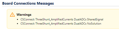

25 REPLIES 25
It may be because of above warnings verify the schematic for current sensing section and MCSDK configuration again.
As per the schematic in the document  UM2197 - User manual
 The OCP circuit is available in the schematics. But im unable to configure the OCP circuit and the MCSDK software shows the hardware doesn't have the OCP. Kindly help me to find where does the problem arises.

Hi @STuser2,
@santhosh16 wrote:
Hi @STuser2,
I have generated the code. But the final settings shows danger here due to no ocp or driver protection enabled.
While I check for the OCP protection, I have came to know that this hardware doesn't have support for OCP protection and I have no idea that where does the driver protection is available.
Kindly help me with this.
