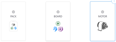

1. Click on New project in MCSDK
2. Click on Motor
You press the one i have shown.

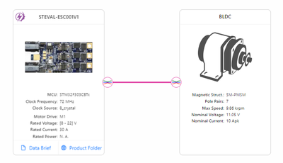

5. The motor will be reflected as shown below which i imported
6. select the hardware STEVAL-ESC001V1 in boards and create and generate the code.

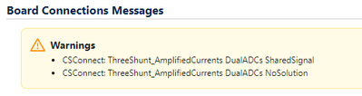

Note:  There are 2 warnings observed
I am not sure of the impact, but code generation is successful.

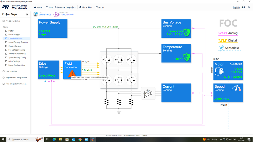

Hi @STuser2,

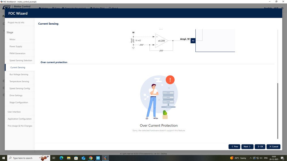

I have generated the code. But the final settings shows danger here due to no ocp or driver protection enabled.
While I check for the OCP protection, I have came to know that this hardware doesn't have support for OCP protection and I have no idea that where does the driver protection is available.
Kindly help me with this.
