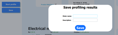

Hello @Gary_Baldy,
Sorry I am a little bit confused...
Firstly, using motor control workbench, you have to generate a project with your boards IHM08M1 + F302R8 + an available motor and "Application Configuration">"Motor profiler" selected.
Compile and flash to microcontroller. Open motor profiler (your used boards will be displayed) and start profiling with your Dualsky XM4240CA-12 motor connected.
Once Profiling ends, you have to save the motor profiling result:
The profiling result is saved in a ".json" file in "~\.st_workbench\hardware\motor" directory and will be available when you will generate your working project.
If you agree with the answer, please accept it by clicking on 'Accept as solution'.
Best regards.
GMA
