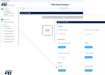

Hello @Frakk2136,
You have to create a custom board .json file based on EVSPIN32G4.json available in "MC_SDK_6.1.0\Utilities\PC_Software\STMCWB\assets\hardware\board\inverter" directory.
Brake feature is described in Motor Brake (example available in power/STEVAL-IHM023V3.json file).
You can also take the advantage of the ST Motor Control Board Designer tool available in MCSDK6.3.2 for example. Based on EVSPIN32G4 board, create a cloned custom board and add Brake feature.

1. Cloned EVSPIN32G4 board in STMC Board Designer, and added Motor Brake Feature
2. Generated IOC project from MCSDK and opened in CubeMX
Unfortunately the Brake feature is not present anywhere past the Board Designer and .json (I checked and the section is created), no pins are initialized.
Am I doing something wrong? Is it not supposed to show up in CubeMX? At least show which pin it is mapped to?

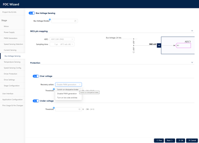

Hello @Frakk2136,
Did you select "Switch on dissipative brake" on Workbench>Bus Voltage Sensing?
If you agree with the answer, please accept it by clicking on 'Best answer'.Best regards.GMA

Nov 19, 2024 6:11 PM UTC
Thank you, I missed that part hidden in there. I was looking for something more obvious but it checks out in CubeMX as well.
