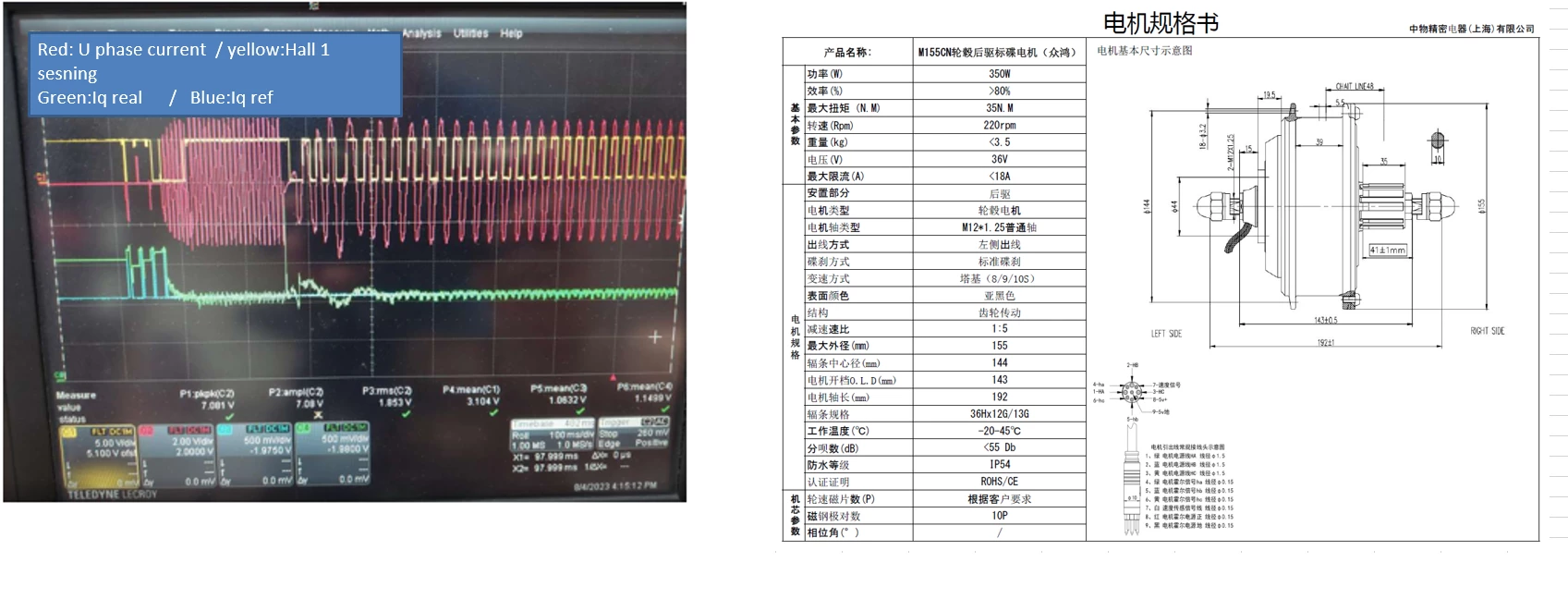

    We are currently referencing the combination of Nucleo-G431 and X-NUCLEO-IHM08M1 to adapt the configuration onto our custom-designed board. The main difference in configuration between the two lies in the MOS and driver, which have been modified to handle higher current.
    The motor being used is the M155CN drum motor with a pole pair count of 10P. The design operates at 36V with an average power of 250W.

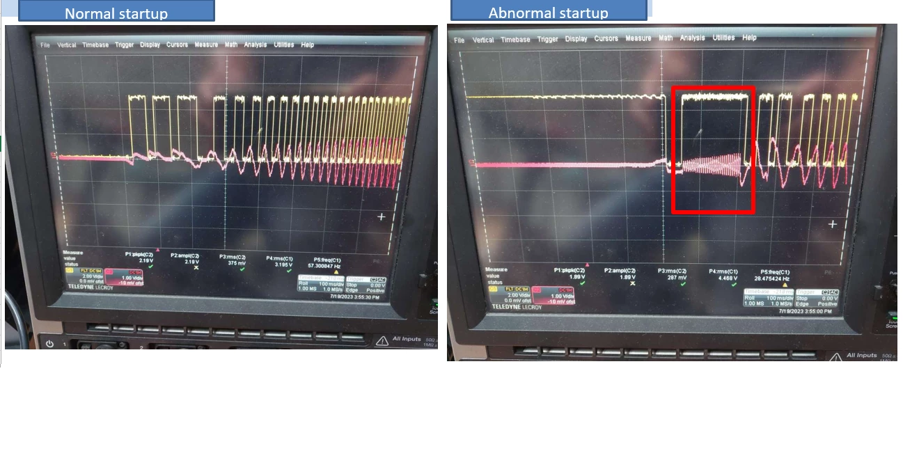

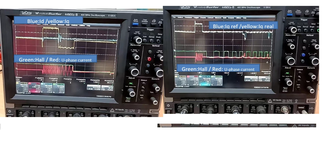

    The observed abnormal phenomenon involves a high-frequency signal in the U-phase during the startup phase, leading to a audible magnetic noise from the motor. This phenomenon occurs around 70% of the time, specifically during startup with a load. Startup without a load is normal.
    We have attempted to address this issue by waiting for the motor to return to an idle state before executing the next action. The occurrence of this issue is closely tied to the motor being near stoppage, and we have also observed the same event during stop-and-start sequences.
    The specific description of the anomaly is that the U-phase current experiences high-frequency oscillations during startup when there is either no Hall signal or within a single Hall signal cycle.

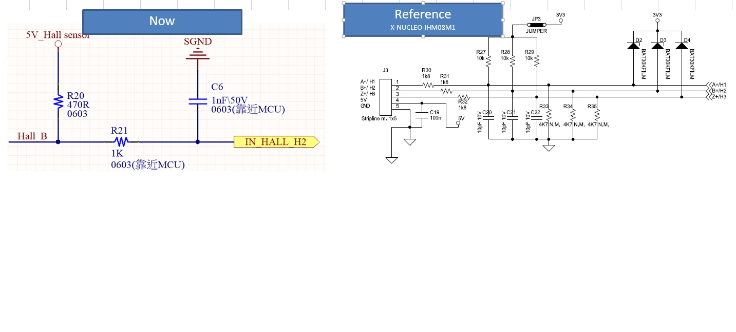

    Under normal conditions, a U-phase current aligns with the Hall signal. Currently, direct use of the development board results in a high probability of encountering a 'speed feedback error.' As a result, we have made modifications to the configuration of the Hall signal input into the TIM terminal, as shown in the diagram

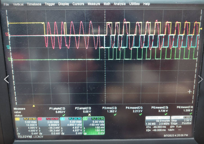

    An update on the current status: I generated a new code using version 6.1.2 to compare and update HALL_Init_Electrical_Angle / HALL_CalcAvrgMecSpeedUnit to the original version 5.4.8. This has resulted in an improvement in the frequency of occurrences, with a significant reduction in the frequency. However, there is still a chance of it happening intermittently. I have also conducted a comparison by measuring three Hall signals against the occurrence. It appears that the issue occurs when the magnetic excitation takes place before the Hall signals are generated. This seems to be related to the positioning angle. Is there a corresponding solution or reference article available for this particular issue?
    Red: U-phase current1629449831338254.png
