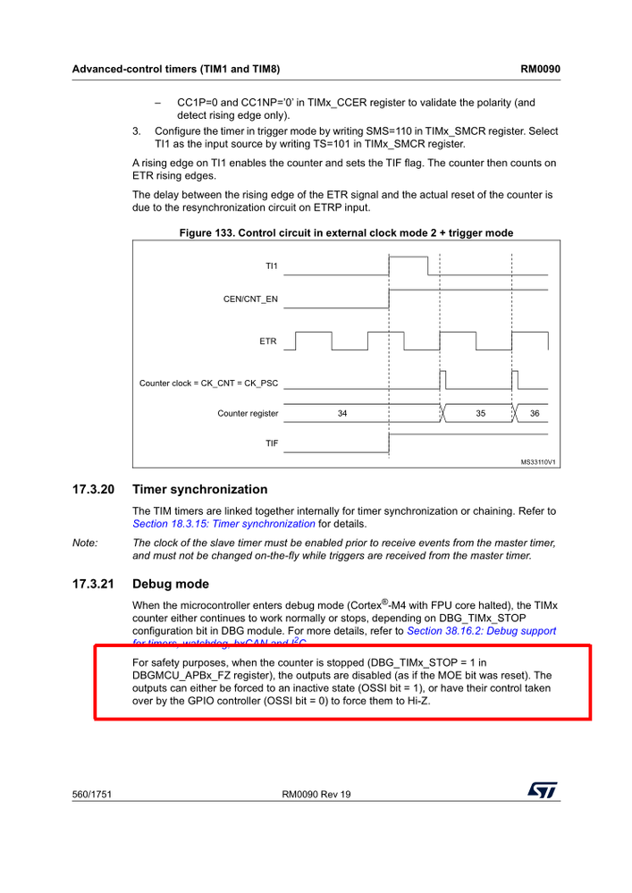

Hi @Fred V.​ ,
Are you talking about this:
For safety purposes, when the counter is stopped (DBG_TIMx_STOP = 1), the outputs are
disabled (as if the MOE bit was reset). The outputs can either be forced to an inactive state
(OSSI bit = 1), or have their control taken over by the GPIO controller (OSSI bit = 0) to force
them to Hi-Z.
Is this only in the 'F3 and 'G4 mcus?
Is this only in the Advanced Timers (TIM1, TIM8, TIM20)?
I'd recommend to add this to the overall block schematics of these timers, it may be quite surprising to the unaware.

Hi @waclawek.jan,
I am indeed talking about this. The Debug Mode seems to exist on all timers (usually described the last sub-section of the functional description of the timer. However, the safety behavior you mention is not. You can find it on Advanced Timers, HR Timers and some GP Timers of the STM32F3, F7, G0, G4 and H7. It is not present on F0 and F4. I did not check the other series.
BR
Fred
