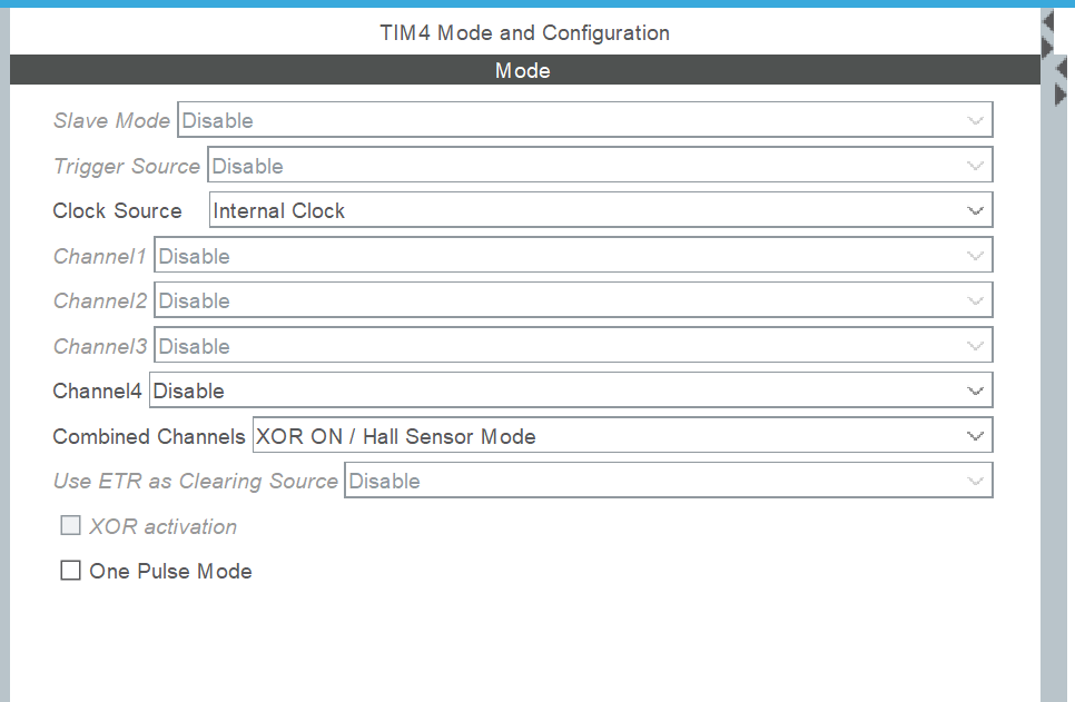

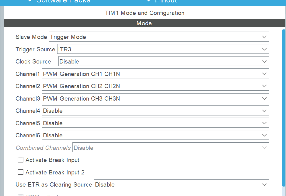

I am using HALL sensor mode on Tim4 and PWM generation with TIM1. I don't understand now how do i read hall sensor status .
Tejashree
HAL_TIMEx_ConfigCommutEvent(&htim1, TIM_TS_ITR3, TIM_COMMUTATION_TRGI);
// HAL_TIM_IC_Start(&htim4, TIM_CHANNEL_2);
   HAL_TIMEx_HallSensor_Start_IT(&htim4);
here is my config setting:
0693W00000Hqc4hQAB.png0693W00000Hqc56QAB.pngbelow is my capturecall back function.

Now i don't understand how i should read HALL sensor status using capturecallback function and trigger the desired channel.
Can some help me how I can read the status and trigger the pwm over the commutation event?
