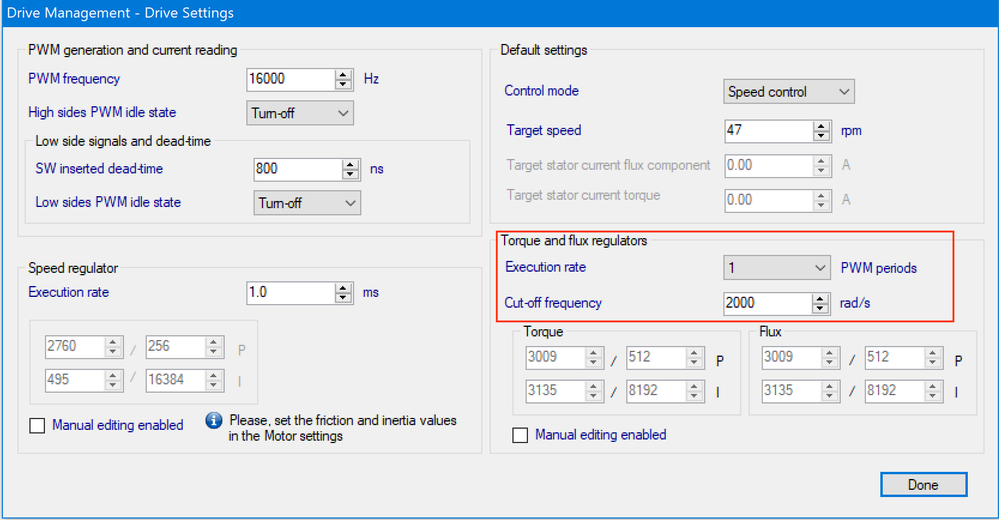

what does mean : "cut-off frequency and Execution rate" in St motor control Workbench
Zschau
do you have any application on the use of variables:
  • execution rate
  • Cut-off frequency
GMA
Please refer to following documentation:
  • Execution rate is rate of execution of FOC function described in "Tasks of the motor control subsystem" chapter
  • Cut-off Frequency is used to compute the regulators for Torque and Flux (Proportional Integral coefficient) described in "regulator" chapters
