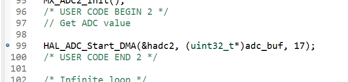

0693W00000JNfd6QAD.pngI am have configured 3 ADC pins (PA4,PC4,PB11) with DMA.I want to read individual values at 3 different PINs.
0693W00000JNfi1QAD.pnghow do adjust the size of the buffer for 3 Pins?Or any other way to read it?

The ADC values are interleaved in the buffer. So multiply the buffer size by the number of channels. The last parameter in HAL_ADC_Start_DMA is the size in Bytes. So 17 seems odd. Use sizeof(adc_buf) or calculate by *sizeof(uint32_t) etc..
If unsure: heavily oversize the allocated buffer, fill it with 0 and validate that only the expected number of bytes/values is written by debugging/dumping the buffer.

 HAL_ADC_Start_DMA(&hadc2, (uint32_t*)adc_buf, sizeofbuf);
Here I tried sizeofbuf as 3.But I cannot read the value .
Can you help me to set the exact value for sizeofbuf.
I am using ADC2.

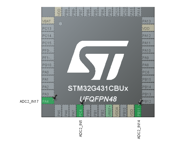

could you post an image of your cubeMX setup for the ADCs?
you should be able to calculate sizeofbuf with that info

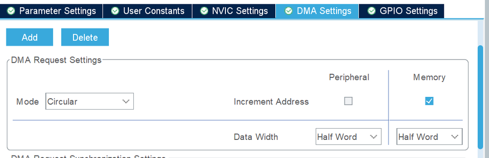

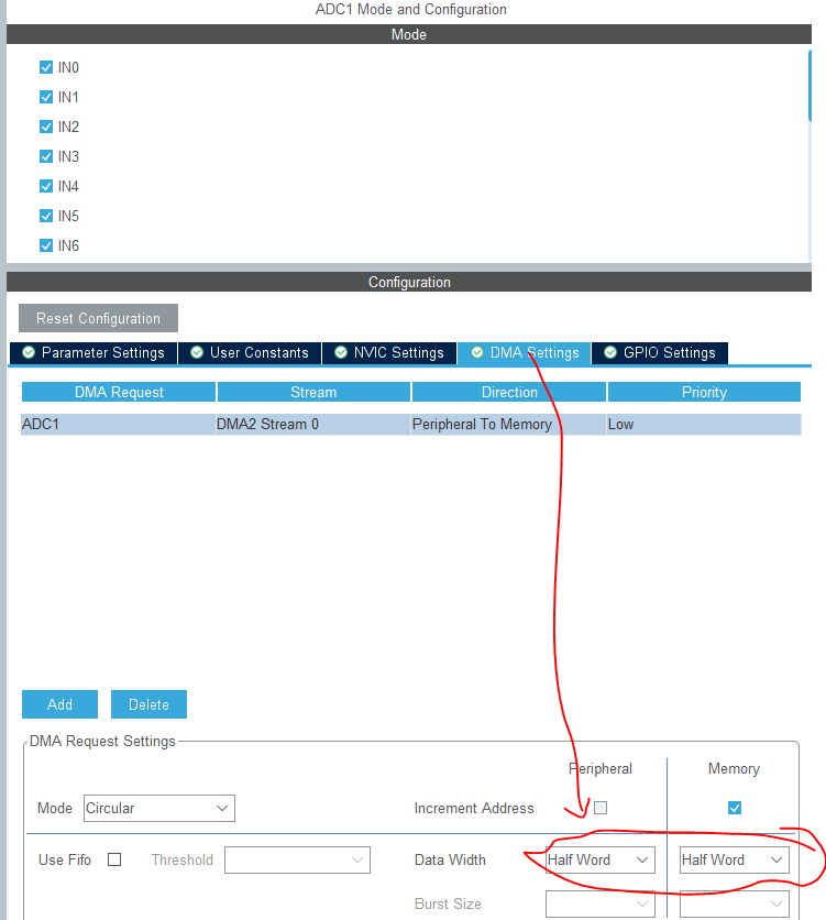

match your receiving buffer unit definition (uint8_t/uint16_t/uint32_t) to the one setup n your DMA
0693W00000JNhcZQAT.pngword=32bits
halfword=16bits
byte=8bits
Available for consulting/freelancing , hit me up in https://github.com/javiBajoCero
0693W00000JNhgbQAD.pngHalf Word = 16 bits
so what would be my buffer size for following Pins?

but your images is chaos DMA show ADC1 instead ADC2 and checked inputs isnt as you write
