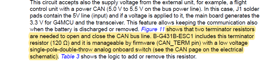

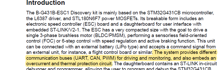

Hi Cedric,The datesheet says it support CAN? I am using B-g431B-ESC1 discovery kit.0693W00000FBrNeQAL.pngAlso 120ohm resistor on board(r26).Do we have to pull CAN_TERM pin high to start the CAN cOMMINUCATION ?

Yes, the board support the CAN bus. But the software part is missing.
